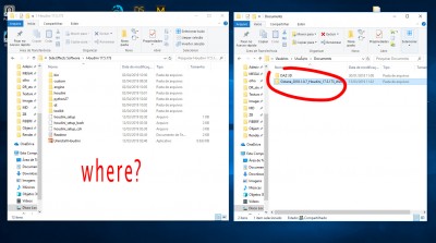

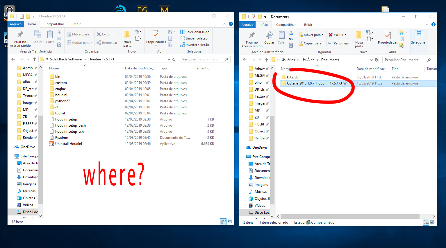

I am Lightwave user, and I have bought Houdini Indie, and I have Enterprise All-Access Plugin License. And this is my first time opening Houdini. I read on the manual that I have to Insert the OctaneRender plugin folder path to the houdini.env file.
But I am not finding this file. I searched for this file, and there is no file with this name.
I put the octane pluguin on:
C:\Users\Usuário\Documents\Octane_2018.1.0.7_Houdini_17.5.173_Win64
And Houdini is:
C:\Program Files\Side Effects Software\Houdini 17.5.173
Can anyone help me?

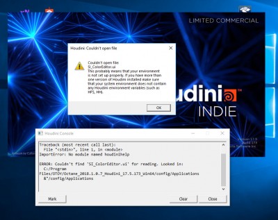

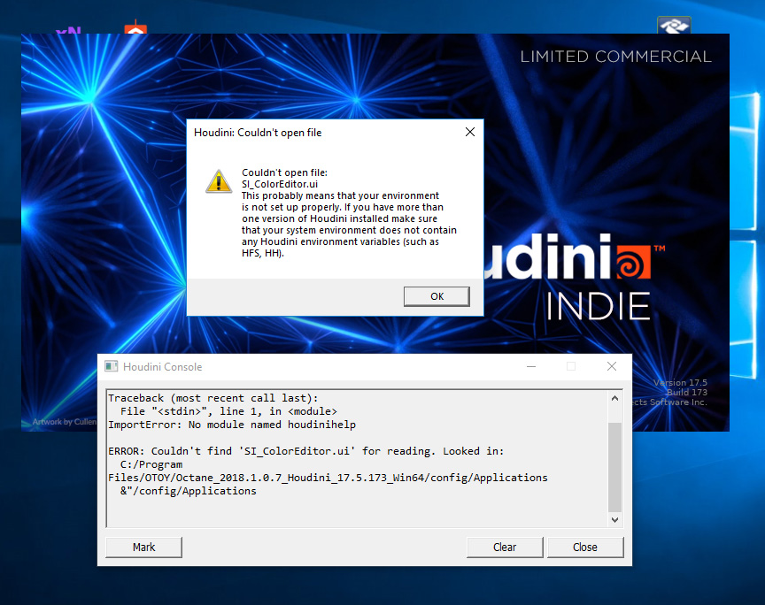

I am getting this message on the console.
ERROR: Couldn't open resource file "resources" (No such file or directory)
Could not initialize the help server:
Traceback (most recent call last):
File "<stdin>", line 1, in <module>
ImportError: No module named houdinihelp
ERROR: Couldn't find 'SI_ColorEditor.ui' for reading. Looked in:
C:/Program Files/OTOY/Octane_2018.1.0.7_Houdini_17.5.173_Win64/config/Applications
&"/config/Applications
