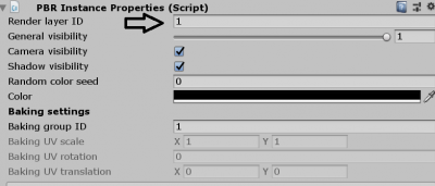

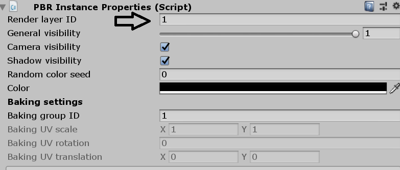

We do not currently support unity layers. Though i think we should check if it is possible to do so.
We do support our own Render Layer ID Each object can be given one.
Then in the Render Target you can select which render layer id's you want to render.
