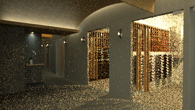

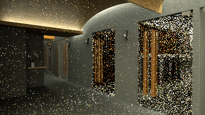

i'm working on a new interior project.
these are the small rendering test(path tracing 1min) for lighting correction, science i add some light source on the ceiling (which is blackbody emitter) the render slowdown immediately especially on the indirect lights. it's not reflect on the s/px value, but the render result is clearly not good.
i have no idea about this situation. is this normal?
problem with little more emitter

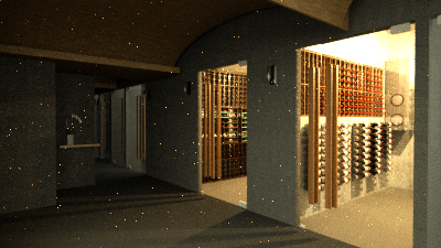

- this render takes 14m30s 16000samples

You could try the P.M.C. kernel in 2.47.That should reduce the fireflies.Also maybe try lighting with an I.E.S. file rather then just a Black body emitter.One final thought is also to try enlarging the black body emitter.Smaller sized emitters tend to make large amount of fireflies.
