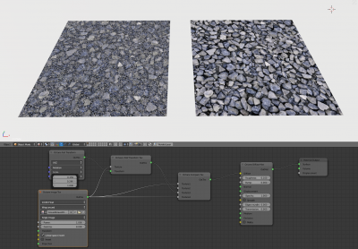

You can achieve this using UVW Transform:
https://docs.otoy.com/StandaloneH_STA/S ... exture.htm
On the left material with shown node setup. On the right normal texture setup.

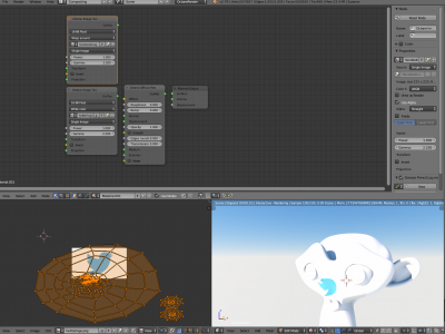

However, I think I figured out how to place one non-repeating image on an object (as shown in the attached .blend and screenshot): By using the "White Color" option in the Octane Image Tex instead of Wrap around.
But I also tried this in another project where it did not work (the image was shown twice, instead of just once.)
And what I still can't figure out is how to place a second , different image on 'Suzanne'...
(I know this is a very basic question :oops: , and perhaps I should rather ask in one of the Blender communities; I'm just not sure if there are any Octane specific options I should be aware of.)

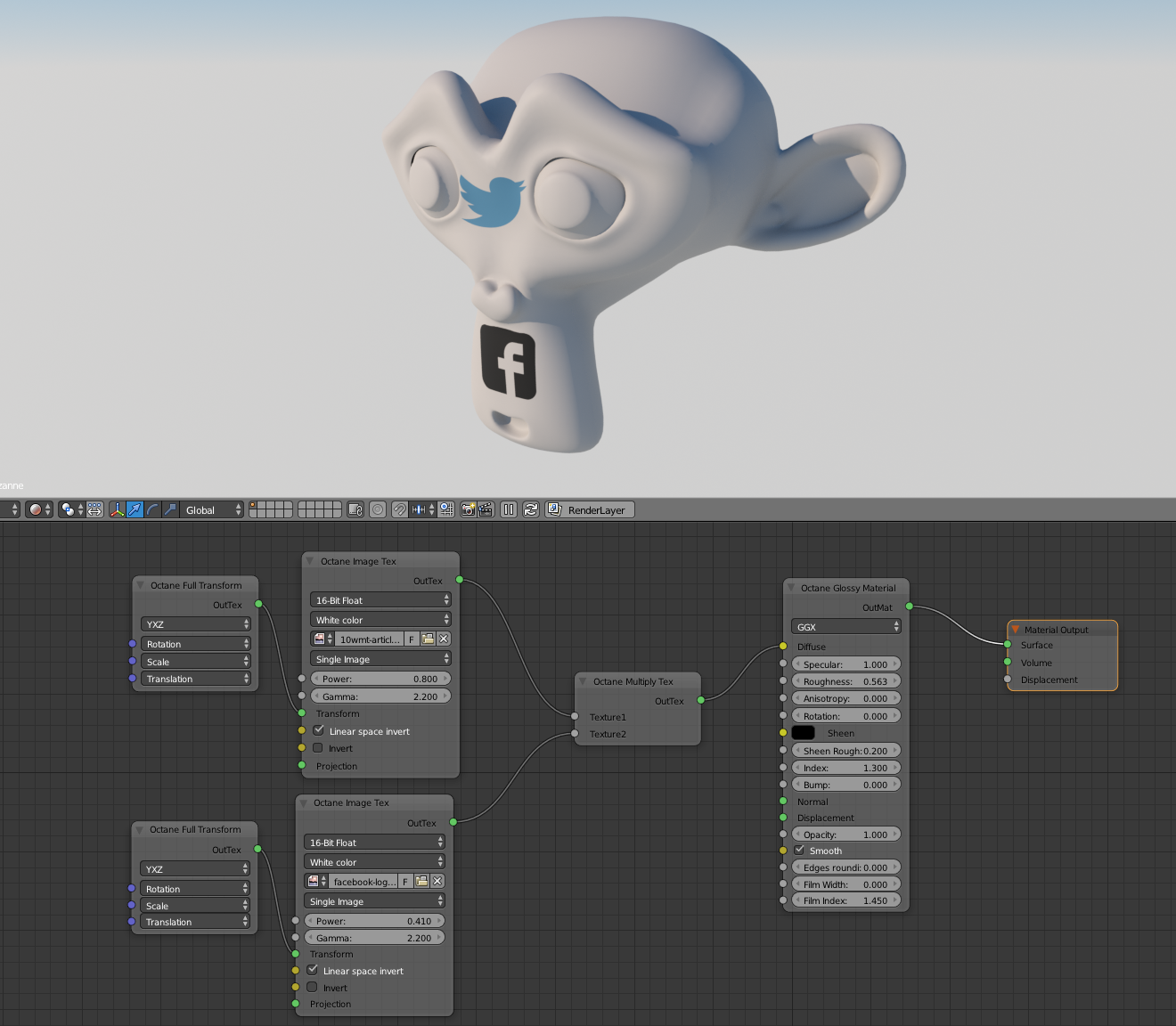

If to want to combine two textures you can try Multiple texture like in the example below:

J.C wrote: If to want to combine two textures you can try Multiple texture like in the example below:
Super J.C -- thank you so much! Just what I needed!
I have literally thought about this for years! :)

To help textures positioning you can use Transform nodes or you can create maximum 3 UV sets (per object) and use them with any texture if you like.

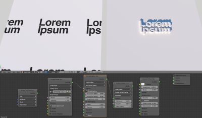

Hello again,
I still can't figure out how to avoid repeating images. (But the other part of my question -- combining two textures on one object -- was completely solved, and thanks for that!)
In my previous posts above, I thought I could avoid repetition by using the "White Color" option in the Octane Image Tex instead of "Wrap around."
However, that does not work. Please see attached image and .blend:
On Blenderartists, I found a description of how to make it work in Blender Render and in Cycles:
For Blender Render, in the Texture / Image Mapping panel change it from repeat to something like clip
For Cycles use a Mapping node with Min and Max enabled
Here's the URL: https://blenderartists.org/t/no-repeat-texture/597168/5
So I wonder if there's a similar trick in Octane? E.g. perhaps some extra node you can insert somewhere to prevent images from auto-repeating?

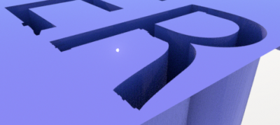

Also, is there any way to smooth/subdivide/bevel edges that are created using a Displacement node? Currently, they look like this up close (higher image resolution doesn't make any difference):
Thank you in advance!

As for the jagged edges, change the Filter type (third drop down of the Displacement node) to Box or Gaussian and then increase the Filter Radius.

Using Octane Baking Texture will help. Set repeating to Clamp and texture type to HDR linear space.
