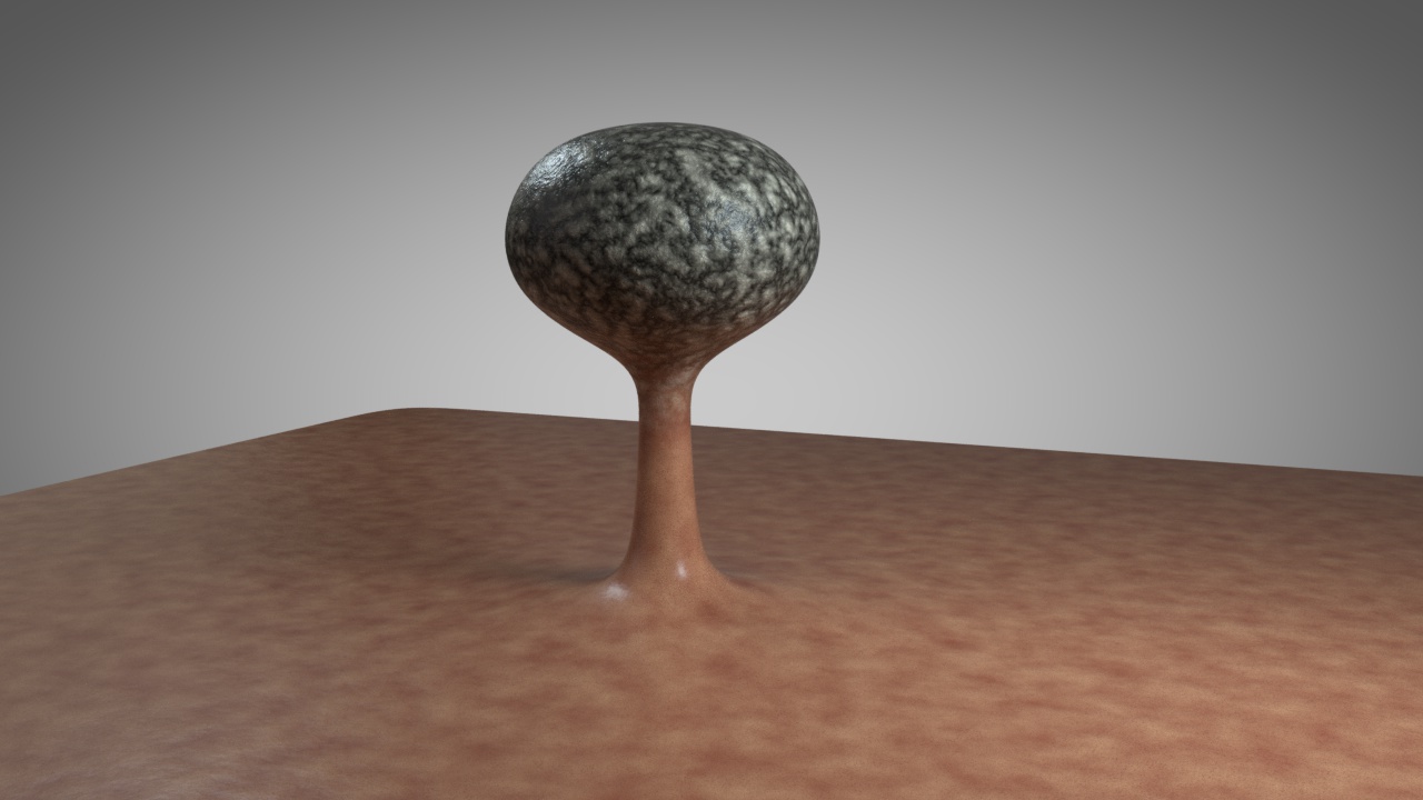

I attached a file showing how I set these things up to get quick seamless distortion free textures. Basically I set my texture tag to a flat projection and the Octane noise to XYZ to UVW. You also notice in the image I attached that I need mix between to textures vertically. Forgot to mention that in my first post. Oops.
The only problem with XYZ to UVW noise is that if you distort the mesh, the noise does not distort with the mesh. If only the Stick Texture worked.
