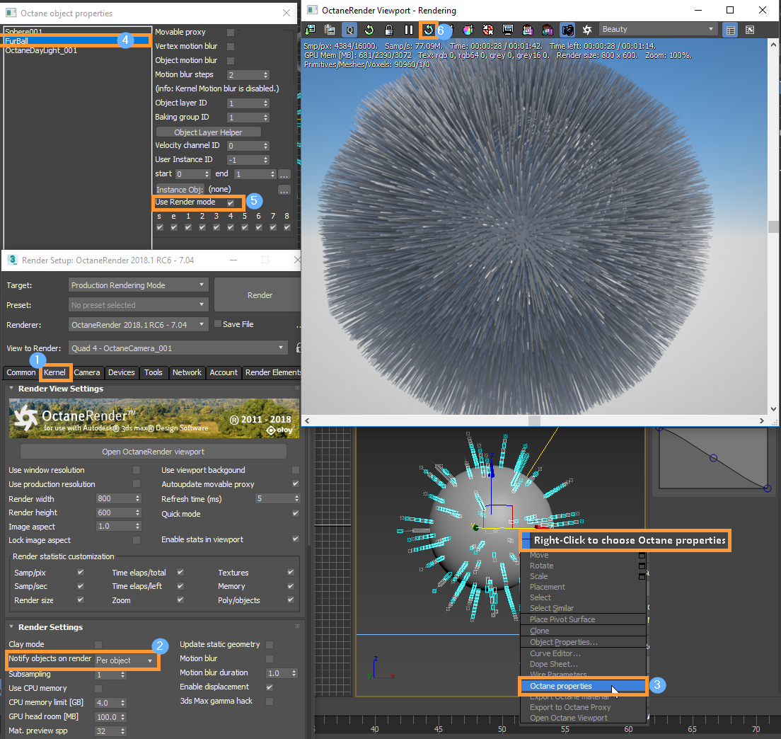

I've said earlier, because I've used Octane for 3dsmax and in it we can render 1% hair in Viewport. Sorry for misunderstanding.
In 3dsmax to render the 1% hair in viewport - we can do this...
I hope this guide will help you to understand, what I want to do in Maya =)
Maybe this is not a bug and we can do this in Maya too =) But I don't understand how can I use this guide in Maya =)) Can you help me?
