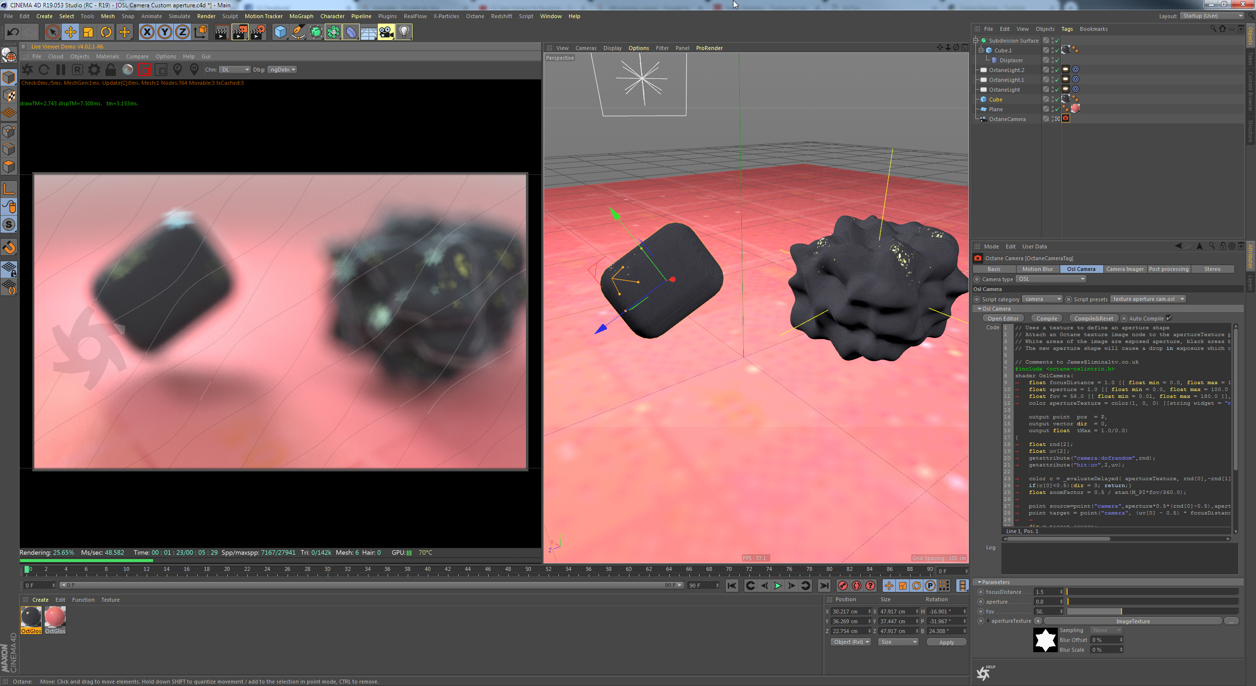

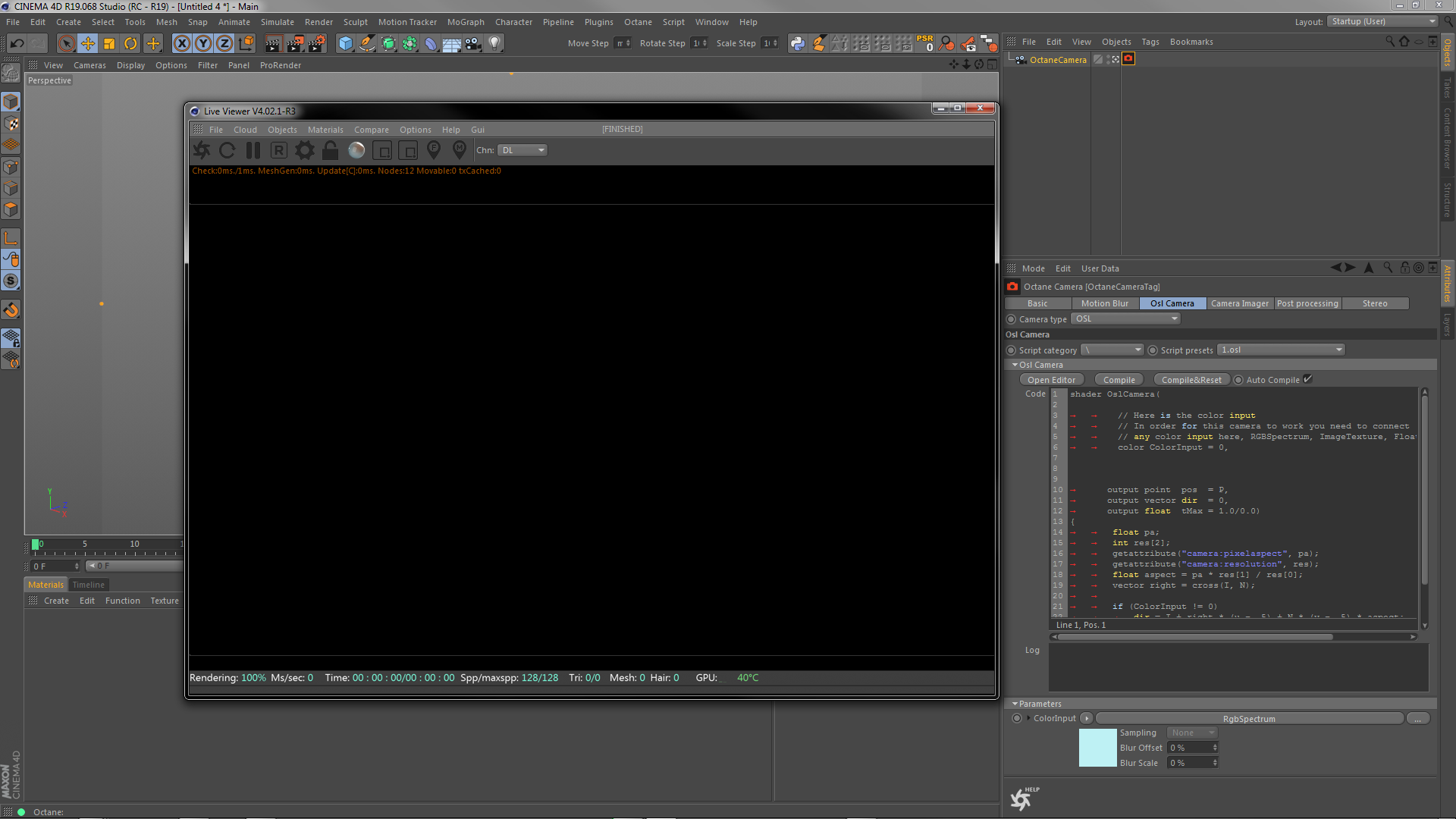

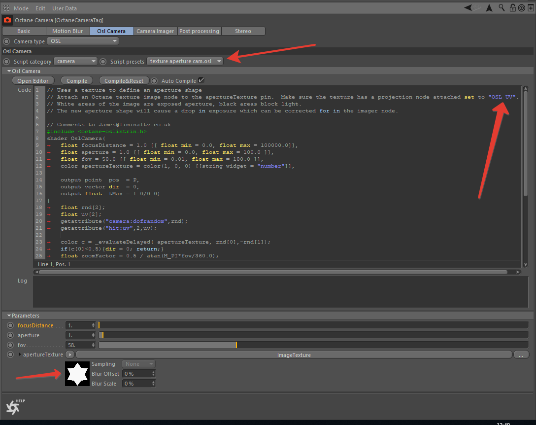

Can anyone explain (and, preferably, attach a working c4d file) how to work with OSL Camera script "texture aperture cam"?
No matter what I do, I get the same black screen.
I follow the instructions, but it doesn't work for me [picture_of_a_sad_cat.jpg]

You should use OSL Delayed UV projection in the ImageTexture node (I guess you already used that but I need to make sure). That's the only requirement.
BUT unfortunately it will not work because there is a bug in the C4D Octane plugin for color inputs in the camera shader. Because of that bug ImageTexture node will be ignored.

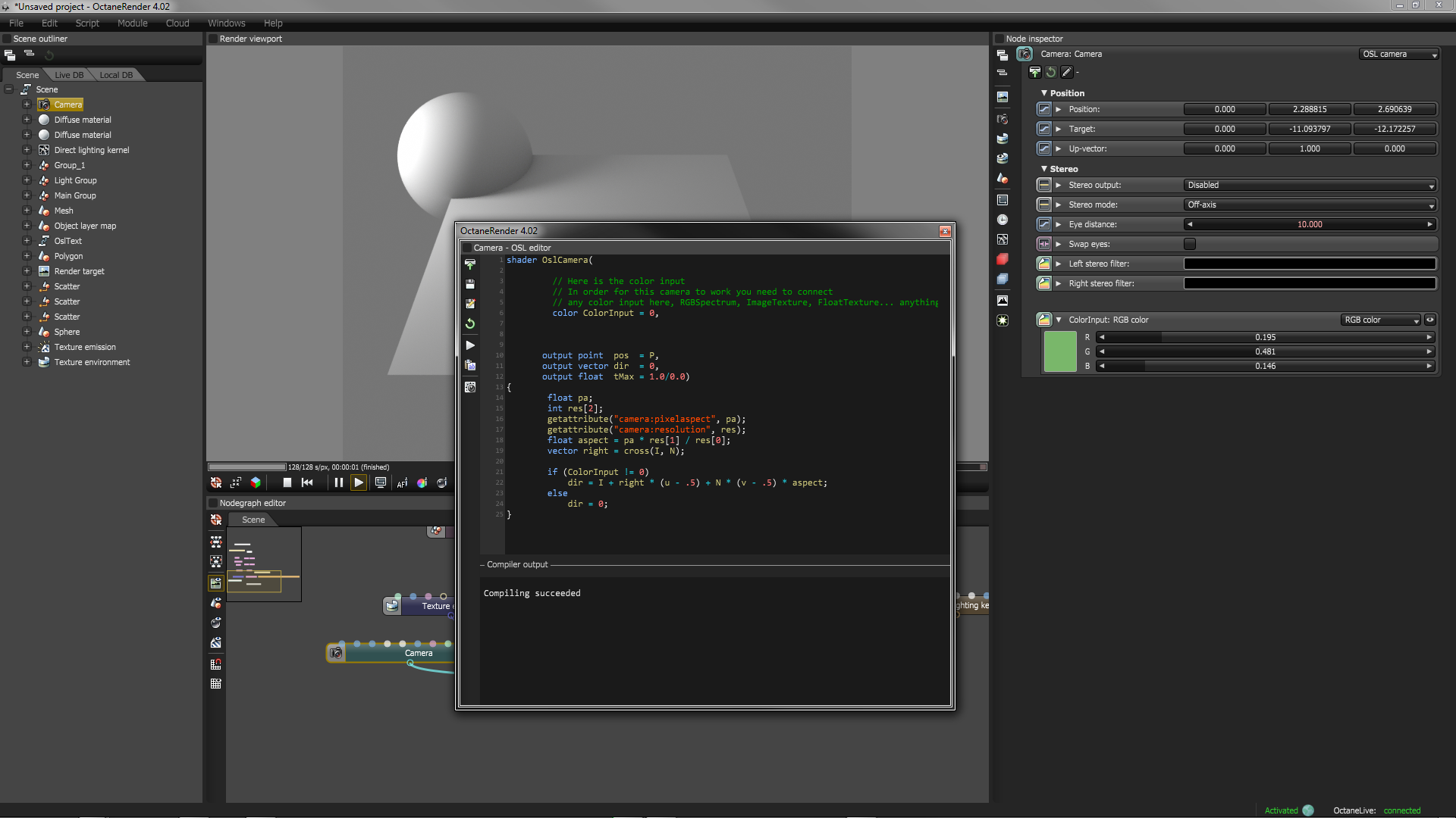

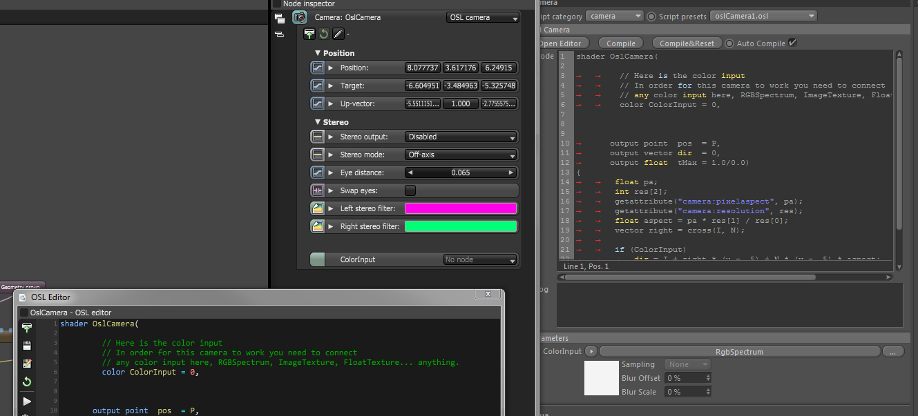

@Ahmet
There is nothing to miss, OSL documentation is very clear about what inputs can be used. And there is not that many of them. :roll:
Color input in the camera shader doesn't work. You can see that the RGBSpectrum node is connected but it's missing in Octane.
This camera will not render black if any non black color is connected on the color input:
Code: Select all
shader OslCamera(
		 // Here is the color input
		 // In order for this camera to work you need to connect
		 // any color input here, RGBSpectrum, ImageTexture, FloatTexture... anything.
		 color ColorInput = 0,
	   output point  pos  = P,
	   output vector dir  = 0,
	   output float  tMax = 1.0/0.0)
		float pa;
		int res[2];
		getattribute("camera:pixelaspect", pa);
		getattribute("camera:resolution", res);
		float aspect = pa * res[1] / res[0];
		vector right = cross(I, N);
		if (ColorInput != 0)
			dir = I + right * (u - .5) + N * (v - .5) * aspect;
		else
			dir = 0;
As you can see it works in Standalone if we add any other color than black:
In Cinema 4D we get this:
Regards
Milan
