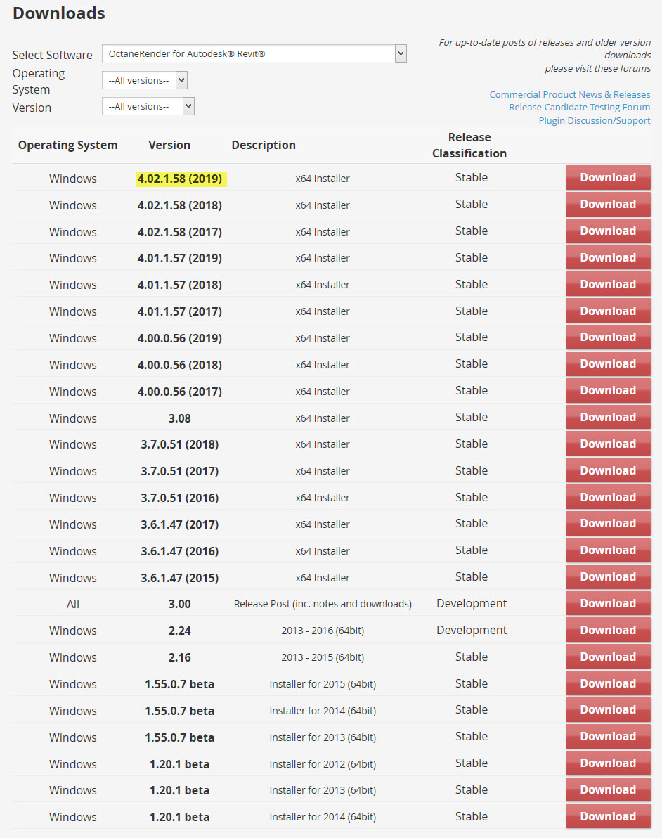

3. When I follow the license section to the Revit plugin latest version download page (for Studio), we get version 4.02.1.53 (2019) - I presume that should match the STABLE download link in this post, and that page just has not been updated as yet?
Kindly clarify.
OTOY will most likely update this page in the next day or two.

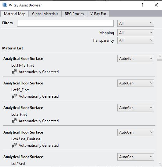

It seems the bug is still there which had been mentioned half an year ago: viewtopic.php?f=61&t=69927&start=10#p356326
To avoid this, when importing the materials from links, is it possible to include the full path name when comparing the names, if the file name is different they should be considered as two different material. I am not programmer, not sure if this is too much work for you.
What you see from revit what should you get in the octane plugin, I believe this is a commercial and professional plugin should provide.
it is nothing to do with someone's work flow, it just about the plugin's RELIABLITY,
I am not sure what is impossible, what I see here Vray has done this already for many many years (as mentioned before)
