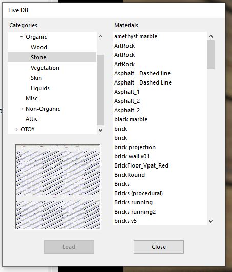

Hi Paul.
Just upgraded to 2018.
I get a scrambled texture preview in the LiveDB.
Any help on this?
Thank you
Any help on this?
Hi - I could not reproduce this issue. Are you using the Enterprise or Studio version? Which version of ArchiCAD?
Paul
Jasonr
Posts: 97
Joined: Tue Aug 02, 2016 2:08 pm
Have a nice week,
Problem fixed. Wrong version of plugin installed.....
I will be more carefull next time!

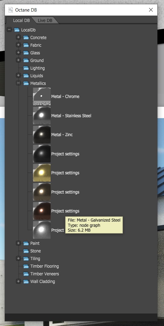

there appears to be an issue with the Name of the Materials that gets displayed in the Local DB (Experimental) if the Material ORBX gets edited in Octane Standalone after the initial creation.
Looking at the image below you can see that the materials I have been editing in Standalone get displayed with the name "Project Settings".
Cheers, Dan.
+MAP Architects, Christchurch - New Zealand
ArchiCAD 4.12 - ArchiCAD 24 || Octane for ArchiCAD
i7-7700K - Gigabyte Aorus Z270X Gaming 9 - 32Gb RAM - 3x Gigibyte GTX1070 G1 Gaming - Window 10 64Bit
face_off
Posts: 15814
Location: Adelaide, Australia
Hi Dan. I could not reproduce this error. Are you able to confirm that it happens with Octane Standalone 2019.1 RC5, and if it does, provide screenshots of the steps you are taking that result in the error.

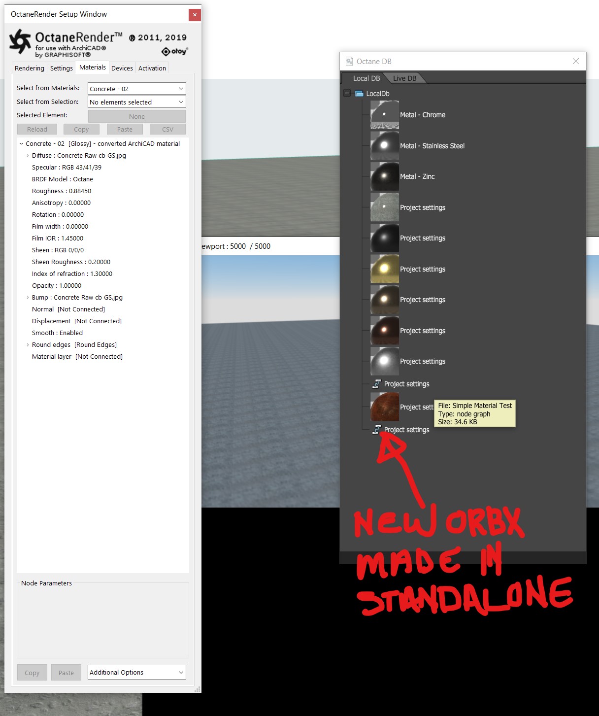

Hi Paul,
the issue, for me, is independent of the version of Octane being used.
I've tired it on a couple of different PC's here in the office and they all exhibit the same issues, whether using AC21, AC22, Octane 2018.1 or Octane 2019.1 (V3 or V5).
I'm also still having the issue of not being able to write different material names for exporting .orbx from the AC plug in.
Just to eliminate a few variables I've also tried to do a complete 'new and reset' of ArchiCAD 22 and start a new project from the AC22 template file, including making a fresh local copy of the AC library (not the lcf).
In the screen shot below I've done a full AC new and reset, created the project from the AC template, saved out a local copy of the Library, reset the Octane settings, made a local copy of the LocalDB (not on the network) and then created a new ORBX material in Octane Standalone 2019.1 V5, which is a simple white diffuse material.
About the only other thing I could try would be to have a go at it at home just to try and completely eliminate and office/network related issues.
Cheers, Dan.
face_off
Posts: 15814
Thanks Dan. I am still unclear on the exact workflow you are using to do this, and if the ArchiCAD plugin is related. Does the problem occur if you create the material in Standalone, and then click the refresh button on the LocalDb in Standalone? If so, then this is an Octane Standalone issue, which you would need to report in the Octane Standalone thread.
Paul
Daniel_Ward
Posts: 158
Joined: Thu Apr 30, 2015 2:57 am
Location: Christchurch, New Zealand
Hi Paul,
yes, you are correct, it appears that any LocalDB Material ORBX files edited or created in Octane Standalone end up with the display name "Project Settings".
It's a bit ironic that Material Orbx files created from the AC plug in will at least inherit the ArchiCAD material for the display name.
Anyway, will post in the SA thread.
Thanks for your help.
Cheers, Dan.
