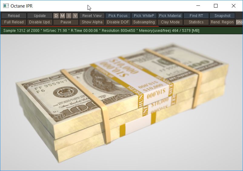

Well, as you can see there are no problems with the materials in this scene once configured. The only problem is that of course the exterior package doesn't allow to see the internal money object if it is opaque, so in this scene I've made it near transparent. Attached you have the scene.
Hope it helps,
-Juanjo

oh wow thank you! I was setting the materials up completely improperly compared to your version of the scene haha, thanks again this definitely helped me understand materials within Octane better!juanjgon wrote:Hi,
