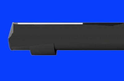

I'm currently doing my first bunch of product renderings and I am really struggling to find the correct settings to render an accurate Layer Mask that i can use as an alpha channel when editing in Photoshop.
I found several Threads regarding a white fringe on the mask (it is a few pixels too big) - but none of the solutions seemed to work. As i will be working on tons of products, i really need to limit the amount of post-processing necessary.
White fringe too to mask being a few pixels too big always.

When trying to use the "render Mask" File in Photoshop, the mask is too big (see picture attached).

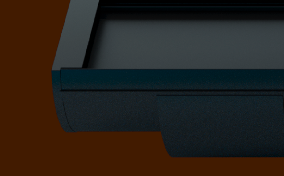

bepeg4d wrote:Please, use Object Layer Color pass, and set the desired color with an Octane Object tag:
Hi Beppe,
thanks for your reply - i tried it, but i still get a white fringe. It's smaller now, but it's still not accurate. Anything else i can try? :)
Thanks in advance
Sundance

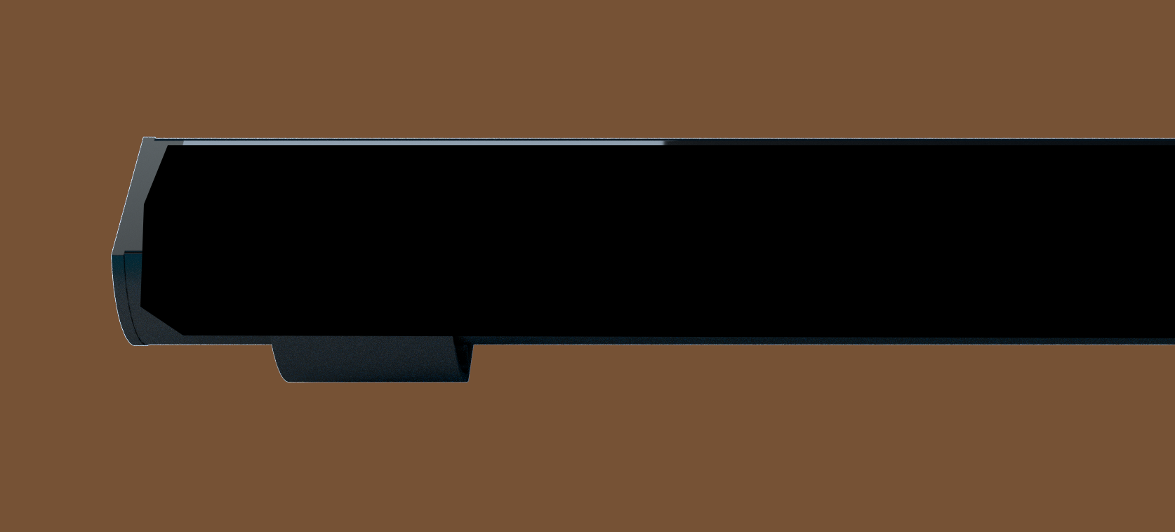

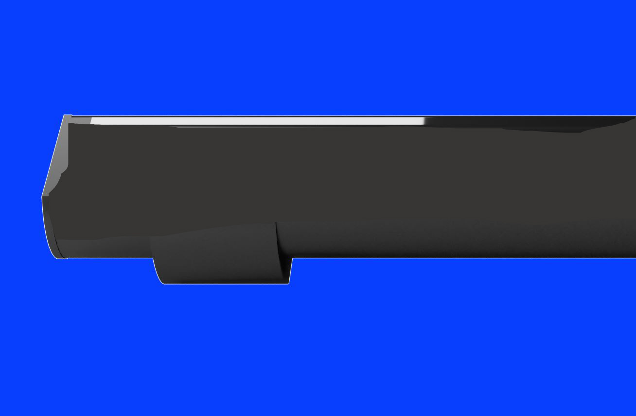

I have also attached the problems in the resulting render again, using the settings from the file. (you can see the white spill on the edges - it happens when i try to use the Object ID Color pass as a mask in Photoshop - same thing in After Effects using it as a track matte. so it's unlikely to be a PS error):
Alpha Problem
Alpha Problem

Perhaps you can upload a cropped version of your photoshop file.
It looks to me like your mixup is there rather than your render.
