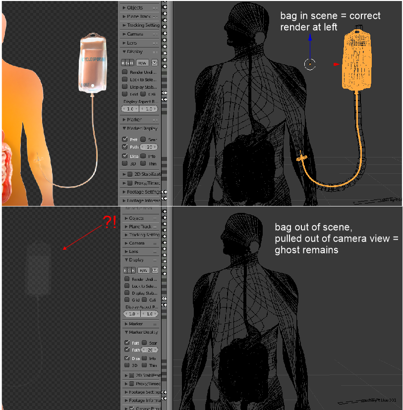

Following an overnight render in which I have an object completely pulled out of view once its visibility is reduced through General Visibility within Octane properties from 100 to 0,
you will see that a ghost remains.
The object, is off the stage, yet still rendered as a ghost for the next 400 frames.
Running out of work arounds here. Please let me know if I am doing something wrong here.

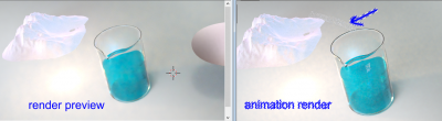

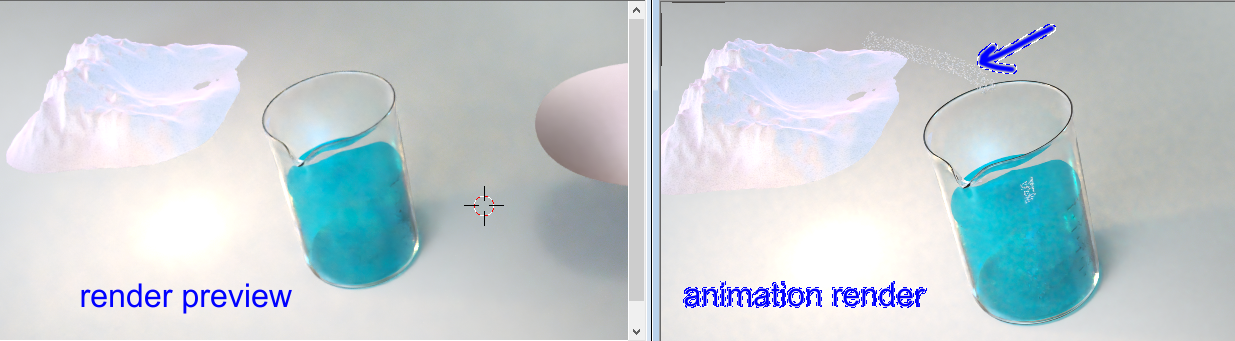

This again shows the inconsistency between render preview and render. In this case, the indicated flecks were opacity channel controlled.
They are supposed to be gone. I have re-rendered with the correct results.....but I am confused as to why.
Is there some scenario in which having a render preview not match outcome is an advantage? Totally screws up workflow from where I stand.
Losing a ton of time.
Some help please?

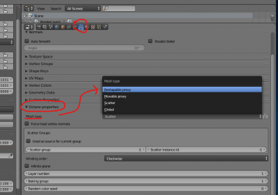

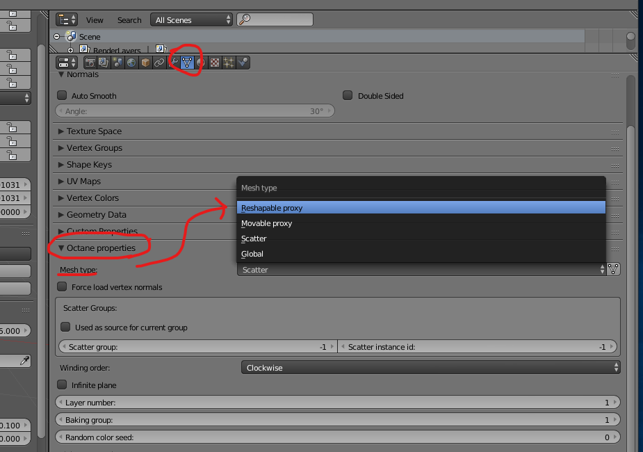

I Cannot find what you are referring to : ("Data-Octane properties-Mesh type") of the "ivbubble" as "Reshapable" )
Octane Properties, yes? But, nothing about Data, other than Geometry Data....

Thank you for the precise location, Drawfun.
The "reshapable proxy" selection did properly allow for the visibility OFF for the bubble.
The "reshapable proxy for the IVbag did not work.
Other than being a more complicated model with multiple shaders, the IVbag employs a fade out through "General Visiblity" just prior to toggling OFF "Camera visibility".
