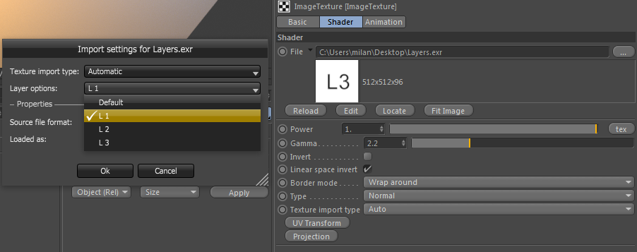

Version 4 of Octane (the render engine not the plugin) introduced an option for ImageTexture node to use EXR layers. So that's what should be immediately possible to change by the plugin developers and it should have been there since the first release of V4 BUT IT IS NOT THERE !
Notice the difference in the UI: That is the closest thing to Photoshop layers with an added benefit that, since you're working with EXR, you avoid any color space ("Gamma") issues, it loads faster than compressed formats and (contrary to popular belief) it can be a significantly smaller file than PSD if you need anything more than 8bit.
In order to save EXR with layers from Photoshop you can use a free ProEXR plugin (there's one for PS and AE and works much better than the older builtin version) from Fnord.
If you want to see what can be added to the plugin, all it takes is a double click on the Standalone app. If you see something that's there but it's missing in the plugin, that can probably be added by the plugin developers. For other things, make a feature request and if it's a good idea I'm sure a lot of people will vote for it.
