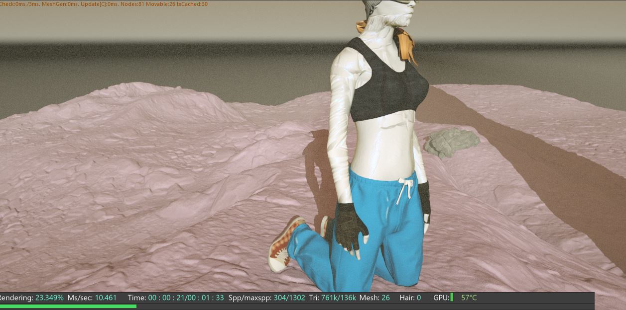

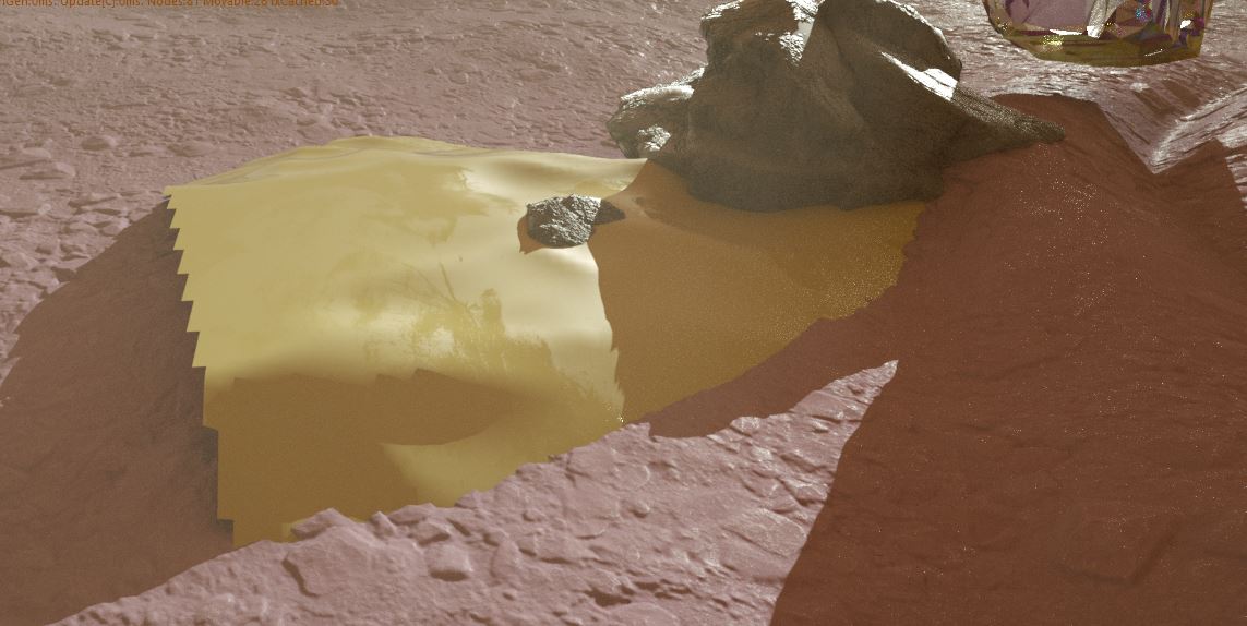

The materials between my character in the scene and the displacement texture have become corrupted. Everything was working normally until I sent the scene from the live viewer to the render engine in c4d. Parts of my displacement material can now be seen on the character in the scene. It looks like the textures have merged together. When I jump back to v3 there are no issues with corrupted textures.
In this image the orange landscape object is supposed to be pink and behave the same way as the texture below.
In this image you can see that displacement is now occurring on the character and the colors are not accurate.
In this video, as soon as I put the character in the scene, materials from the character jump to the displacement materials. I have tried with multiple characters, etc....

Displacement's parameters has changed since V3. Have you checked mid-level, etc?

aoktar, thanks for your response.
Yes , mid level and additional settings were assessed. Displacement in live viewer was also only set to 1024x . Were you able to download and view the video I have attached ? I believe the character materials are being used as the displacement texture as soon as the character is added to the scene.

It's hard to understand from a video. Please share a sample scene for getting a fast help.

Aoktar I am unable to attach the scene file through the forum so please use this link to download the file via wetransfer - https://we.tl/t-KJny1Lq2O0 . After exporting the scene with all assets the behavior changed. Now my displacement texture is being applied to the character in the scene.
