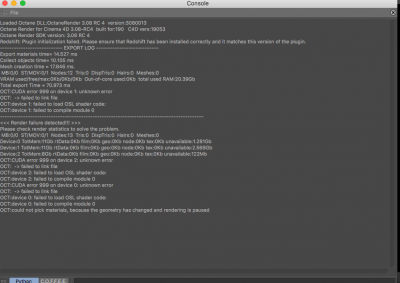

I'm on a Hackintosh still running Sierra 10.12.6, using 3 1080 Ti GPUs, running Octane 3.08-RC4 with C4D R17 (which I've been using without issue for like 8 months)

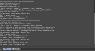

Made no changes to the computers OS, to Octane, to C4D, to basically anything. Last week I went to render something and the render immediately failed with a console error I haven't seen before. Restarted several times but had no success. I'm consistently getting the same error where it says it fails to compile shaders or link the GPU.
Weirdly, I tried running OctaneBench and that worked immediately without issue.
screenshot of C4D log attached
Octane Render Failiure
