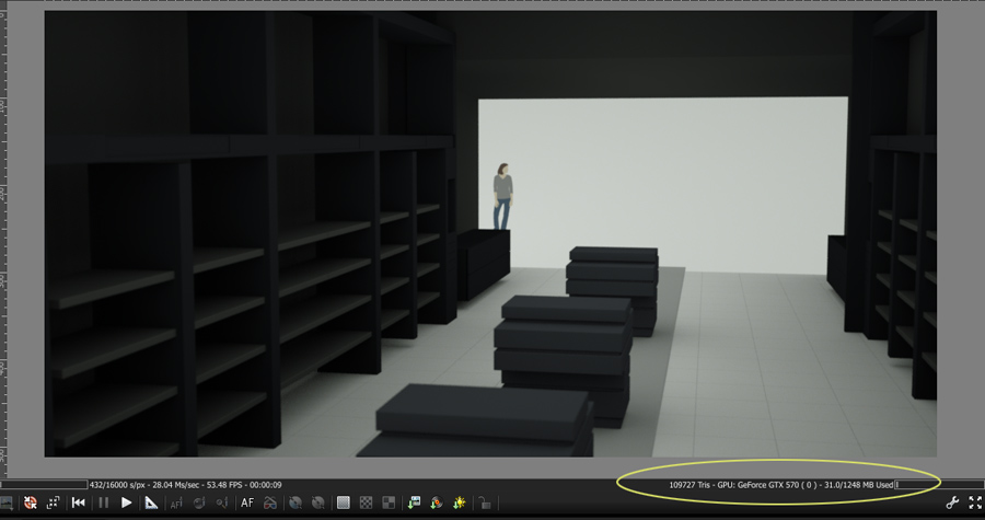

I currently have a GeForce GTX570 and a Tesla 1060C in my system. While octane is rendering it says I only the GeForce and 1280MB used or available.
I invested quite a bit in this big, badass Tesla and I'm wondering why isn't it "in there kicking butt"?
I asked a similar question earlier and was told the Tesla has great video power/memory--when I enter the CUDA settings, it displays both cards and a whopping 5000+MB of memory. My question is: Where did it go and why isnt it being utilized?
I've included a screenshot
Thank You

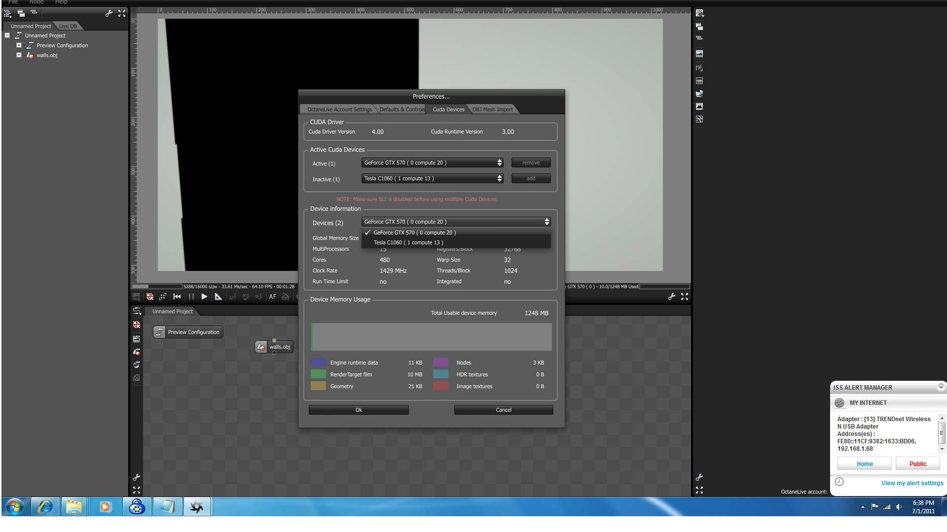

Halalleujah, I finally got Octane to function. In fact, it was the administrator settings in my own machine that were not alllwoing the program, for some reason, to launch. After "giving myself" full admin rights, it launched.
However, the Tesla card is still inactive. I'm running CUDA version, 3.0 which is supposed to support multi-GPU and as you can see, it recognizes the Tesla's existence but at the moment, it's not recruiting it to render.
When Octane was running earlier, it recognized 5000+MB of memory, not the 1280 currently available( the GTX570's limit). Now...nada.
I've attached the screenshot
Any suggestions?
Thank You
Any suggestions?
Thank You
I see on your screen shot that there is an image being rendered in the render window.
You can't set Cuda parameters while the render is running.
Just close your scene or shut down Octane and re-open it without loading a scene, and go back in your preferences and you should be able to select, add or remove the graphic cards in order to enable the Tesla card as active.
Don't forget to save preferences after setting.
I'm almost sure that it will work. Test it and tell us the result !
