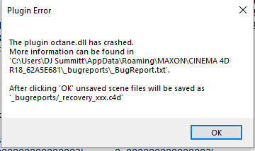

Good evening! I have a couple scenes that I'm struggling with. I press render, it compiles. Then the second it starts to render the first frame I get the attached error message.
I have also attached my bug report.

You looks like having cuda crashes. Isolate scene parts and try to render. Do that for finding the parts which causes crashes. Also what's your driver version?

I'm on 419.17. I will try isolation now & report back. Thanks!
