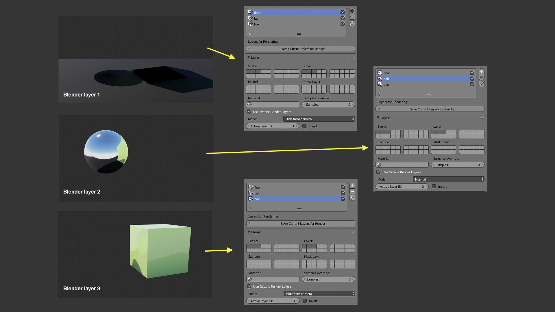

I think, I incorrectly expressed my question about layers. I don't mean layers on modeling step, I mean layers on render. Like in Photoshop (I have the whole render of character, but I need each part of it on seperate layer). I can't render each part seperately and it's uncomfortable. Or sorry and I misunderstood your answer, because I know only one feature of layers in Blender (it's like moving mesh to another layer).

Hi, I ment render layers not just layers. They work fine with Octane plugin. If you want to use masking you need to use Octane layer system.

Here is an example how Octane layerers work with Blender layer system:
