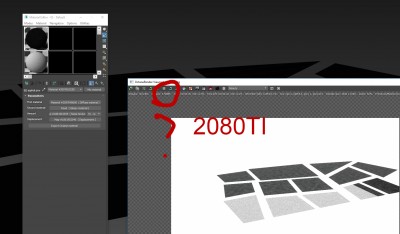

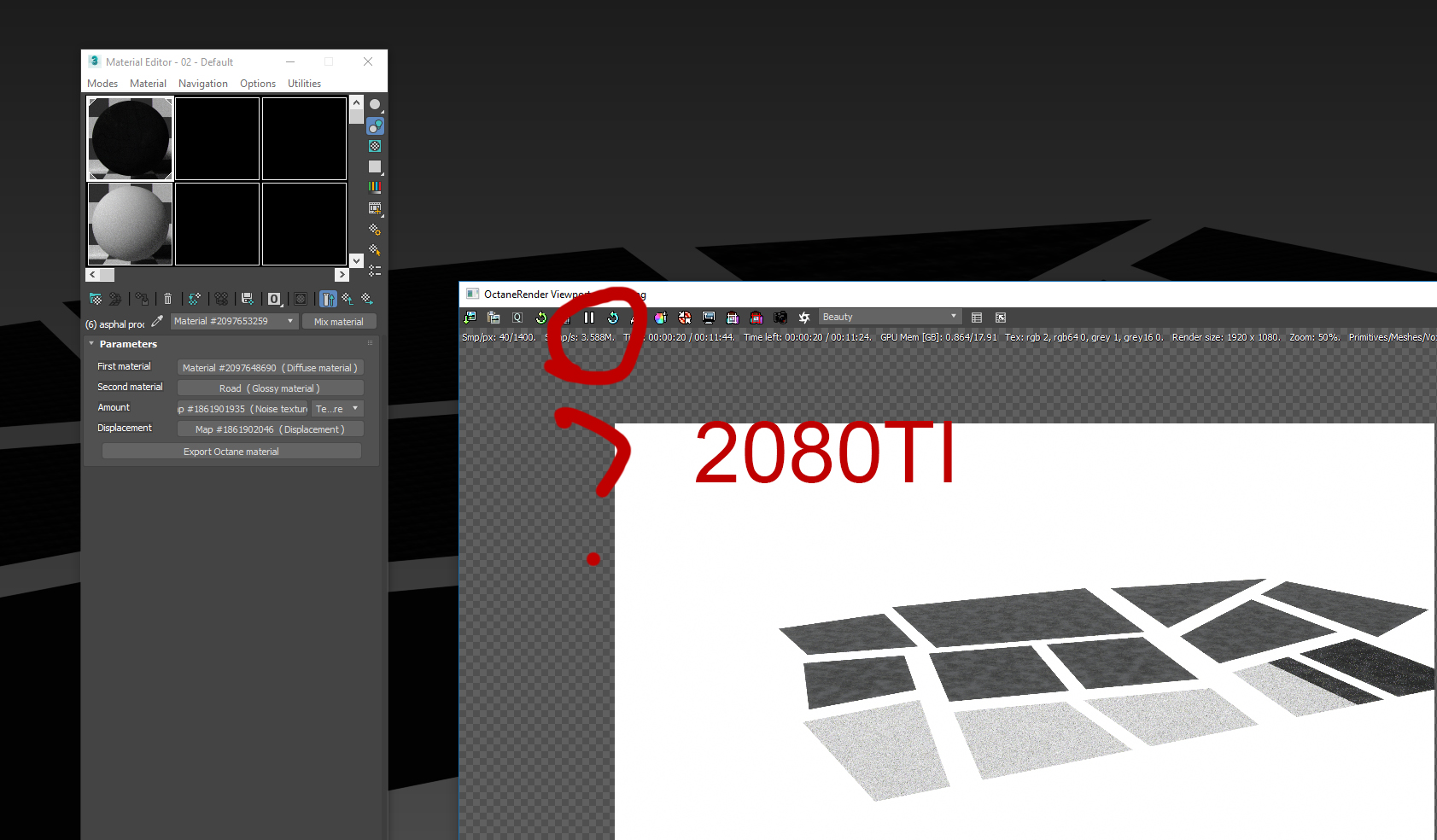

Hi Paride,
can you try the attached scene. With dispalcement I am only getting speed of 3 M samples/s and that with a 2080Ti Please just open octane viewport. is it normal? Thanks
Very slow rendering due to displacement
C. RAM Capacity (i.e. 6 GB)
- Attachments
- slow render bug.zip
- (30.83 MiB) Downloaded 239 times
- paride4331
- Posts: 3994
Hi coilbook,coilbook wrote:UPDATE:
it looks like bad uv mapping of a displacement map was causing slowdown.
that's it.
Regards
Paride
