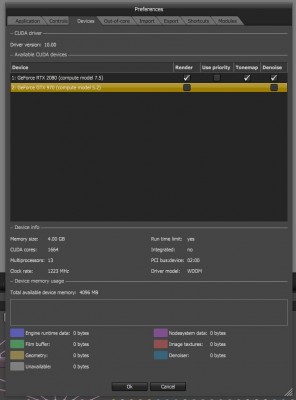

Amazing work as always ! :D works great with my 2080, doesn't seem to like my GTX 970 though, in either standalone or C4D - Error returned = There is no cuda device which is selected.
Win 10 1803
Driver 417.71
Ta.

Sorry, it's not really clear what you mean. Are you saying that you can't select the 970 in the dialog? What happens when you do and is there an error message in the log?
shaddam
Posts: 10
Joined: Sat Jan 21, 2017 12:10 pm
abstrax wrote:
shaddam wrote:Amazing work as always ! :D works great with my 2080, doesn't seem to like my GTX 970 though, in either standalone or C4D - Error returned = There is no cuda device which is selected.
Win 10 1803
Driver 417.71
Ta.

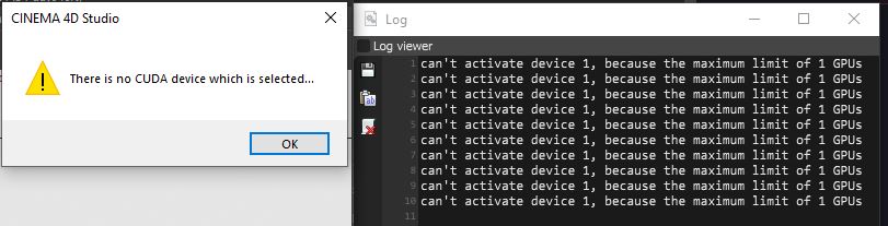

Apologies for not being clear,
In standalone - The 970 is deselected by default upon opening, when going into the preferences and attempting to press the check box to enable the 970 a Red X appears for a second over the checkbox indicating that it cannot be enabled
In Cinema 4D ( R18 ) - The 970 again is deselected upon opening C4D - If i deselect my main card, being a RTX 2080 and attempt to enable only my GTX 970 then attempt to render a scene- I will receive the error i stated above " There is no cuda device which is selected "
After clicking OK, c4d crashes with a bug report screen and quits. is there a way to view previous crash logs ?
EDIT : left the log open whilst running c4d, appears this build is only limited to x 1 GPU ?
EDIT 2 : This was just cleared up with Jules on the slack, ignore my inquiry :)
Posted on the Standalone page right in front of my stupid face :
Please be aware that Studio builds of 2018.1 now support only 1 GPU, and no network rendering
can't activate device 1, because the maximum limit of 1 GPUs has been reached

It will only support 1 gpu moving forward? Are you kidding me? I bought this setup knowing my octane subscription would support my 2080ti and my old 980ti - now you're renegging on that? Will you provide an avenue for customers to get their money back? This is insane.

So this release i downloaded just now should work with two GPUs, my 2080ti and 980ti - but it simply isn't working because of a technical error? Is that what you are saying?
