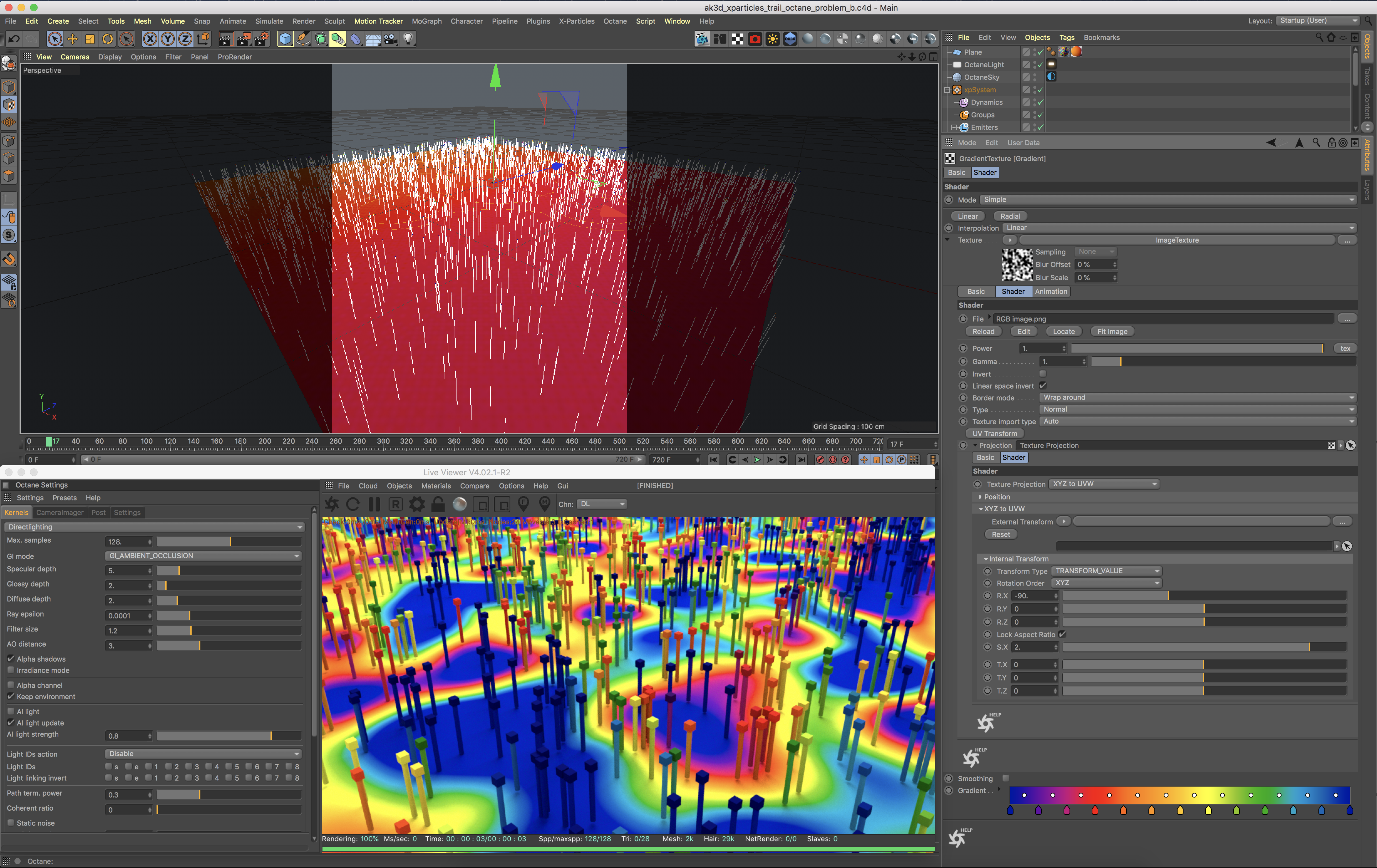

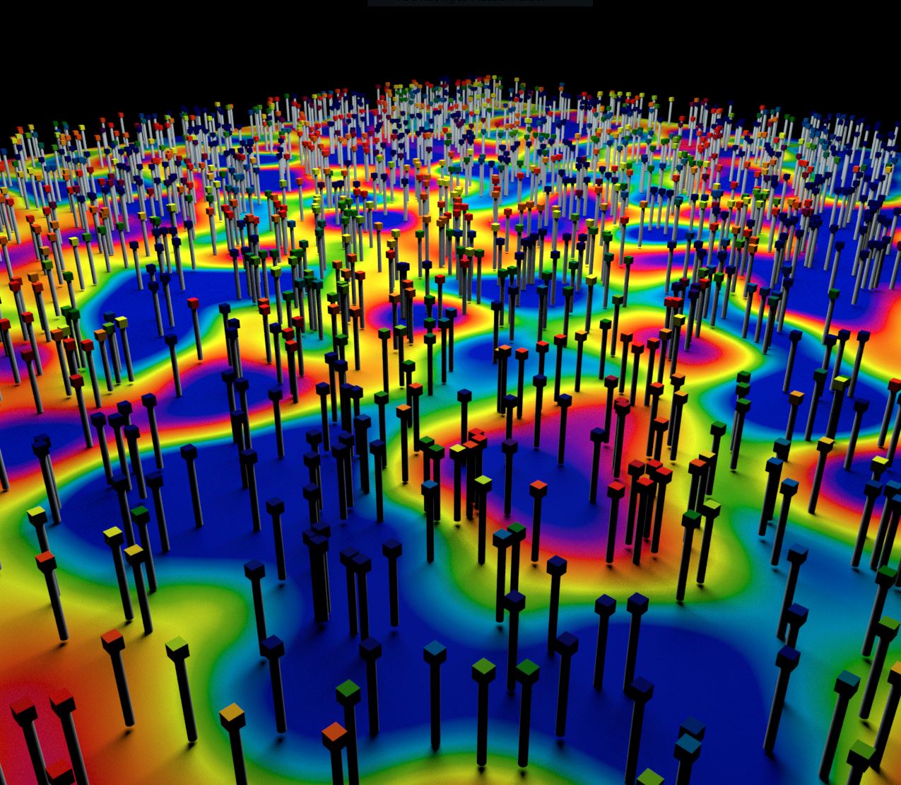

Posts: 10626
here is a solution, by removing c4d shaders, and using a different projection in Planar/XYZ to UVW mode:
ak3d_xparticles_trail_octane_problem_b.zip
(1.04 MiB) Downloaded 180 times
ciao Beppe
