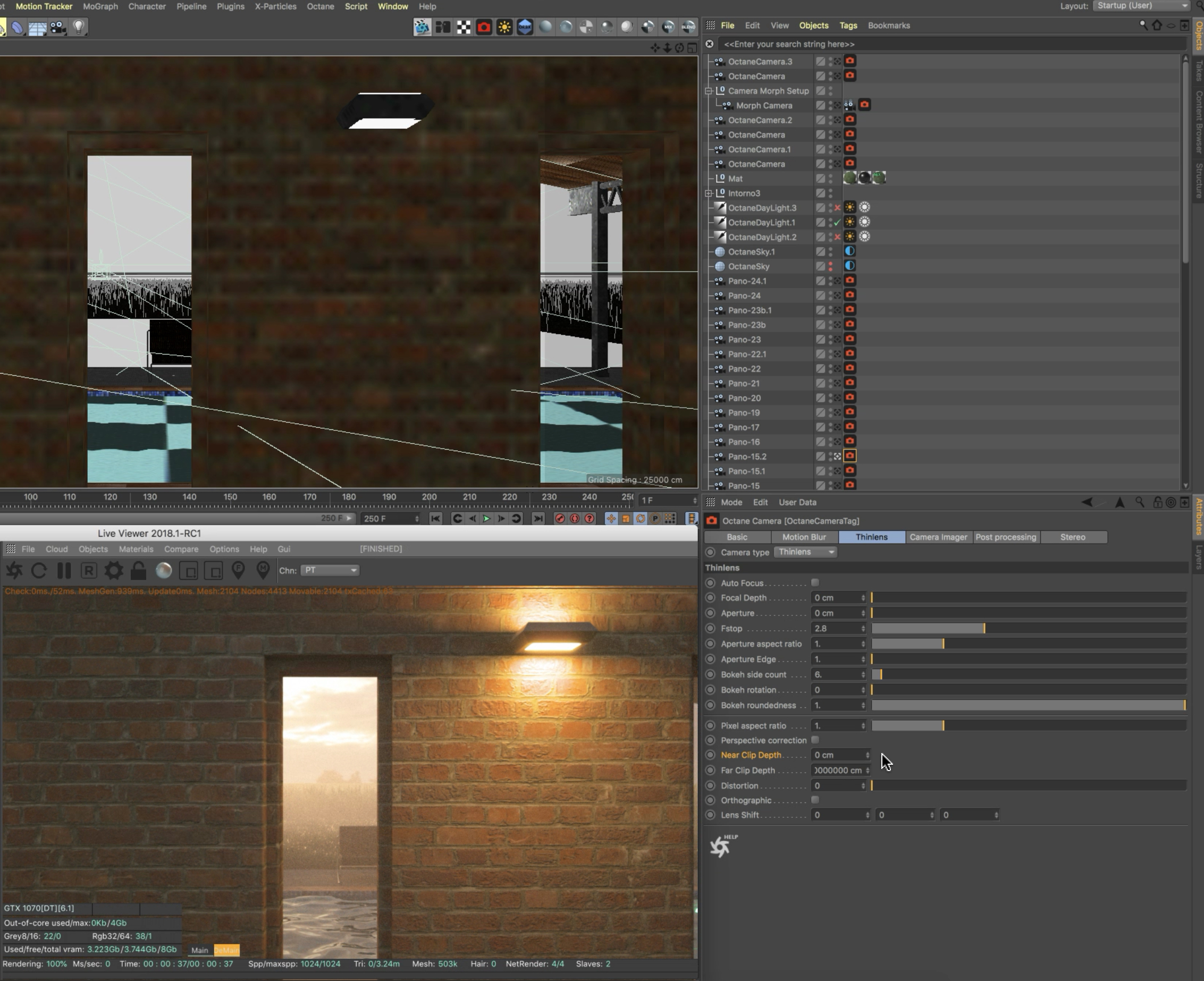

The subject describes the problem. Near clipping has stopped working. It shows in the regular editor window but is not coming up in the preview window. I switch near clipping on but it has no effect.

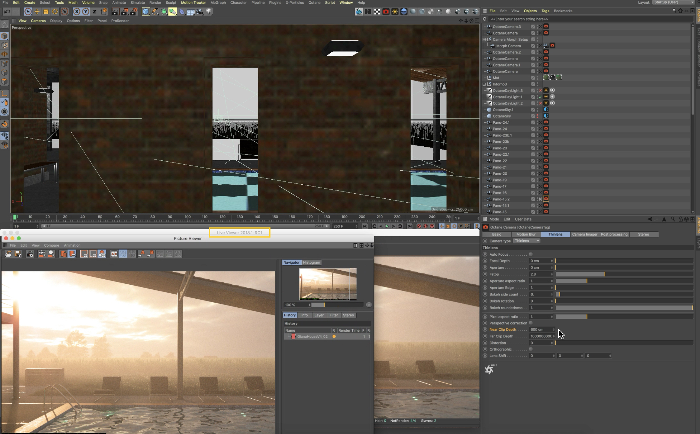

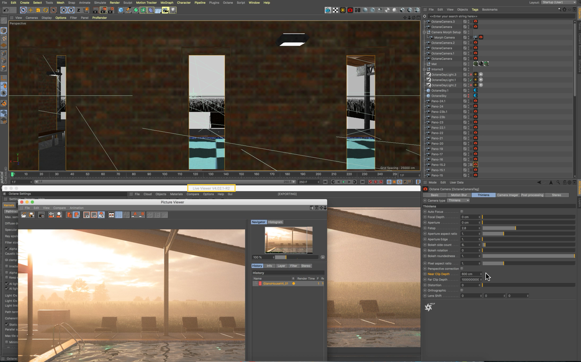

everything is working as expected in v4.02.1-R2:
and v2018.1-RC1:
Here is with Near clipping at 0:
Which exact version have you installed?
