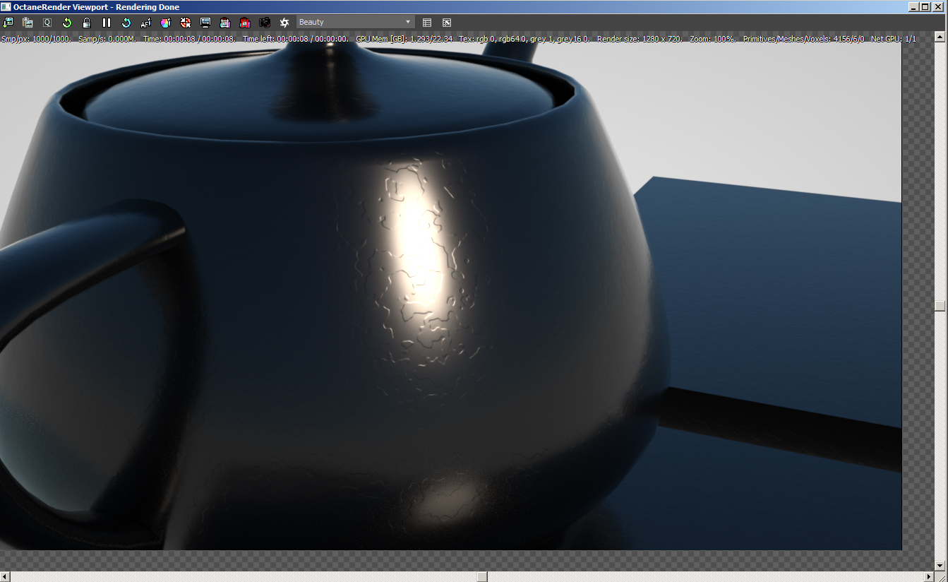

Noise texture is broken in the bump map slot, possibly all procedural maps. I tested specular, diffuse and glossy materials, noise and saw wave maps, none of them work in the bump slot. RGB and Greyscale image maps work just fine. Version 4.01.1 - 6.12
See attached image. On the left are maps in the bump slot, on the right is the exact same map in diffuse to illustrate the mapping is working. The forward set is using a noise map, the back set of boxes is using greyscale image map.

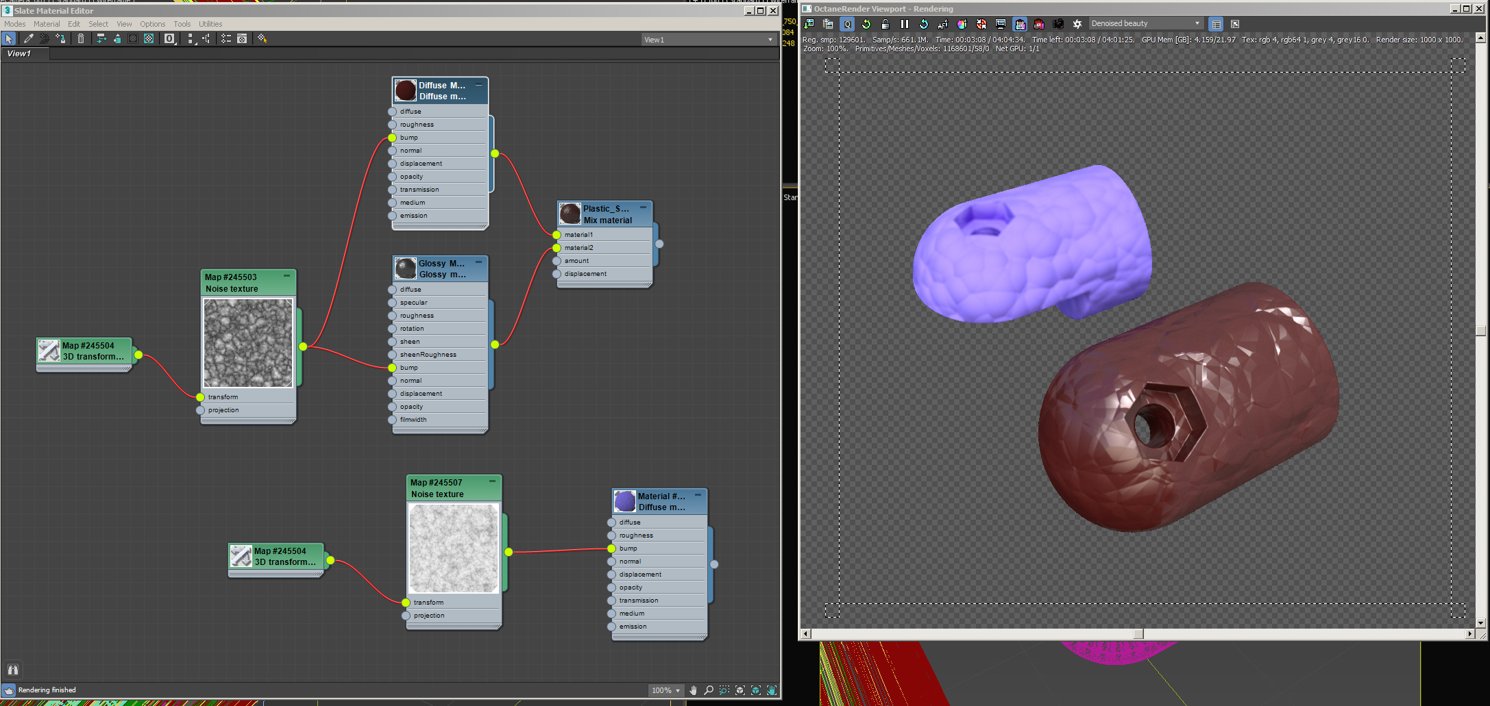

Attached is a test scene in which it's broken for me. Tested it in 6.12 and 6.13.
I created another test scene with a very small scale(1 unit sphere) and it works fine. The scene above is considerably larger in scale. Maybe it has something to do with scale.
Bump Test.zip
(239.33 KiB) Downloaded 496 times

I made this test, the scene is around 300x300 mt.
As youy can see noise bump map works, but height doesn't encrease, rightly I think, using a bump map.
Using noise bump map in displacement you can edit height.
Said that I will ask to developers what they think about.
Regards
Paride

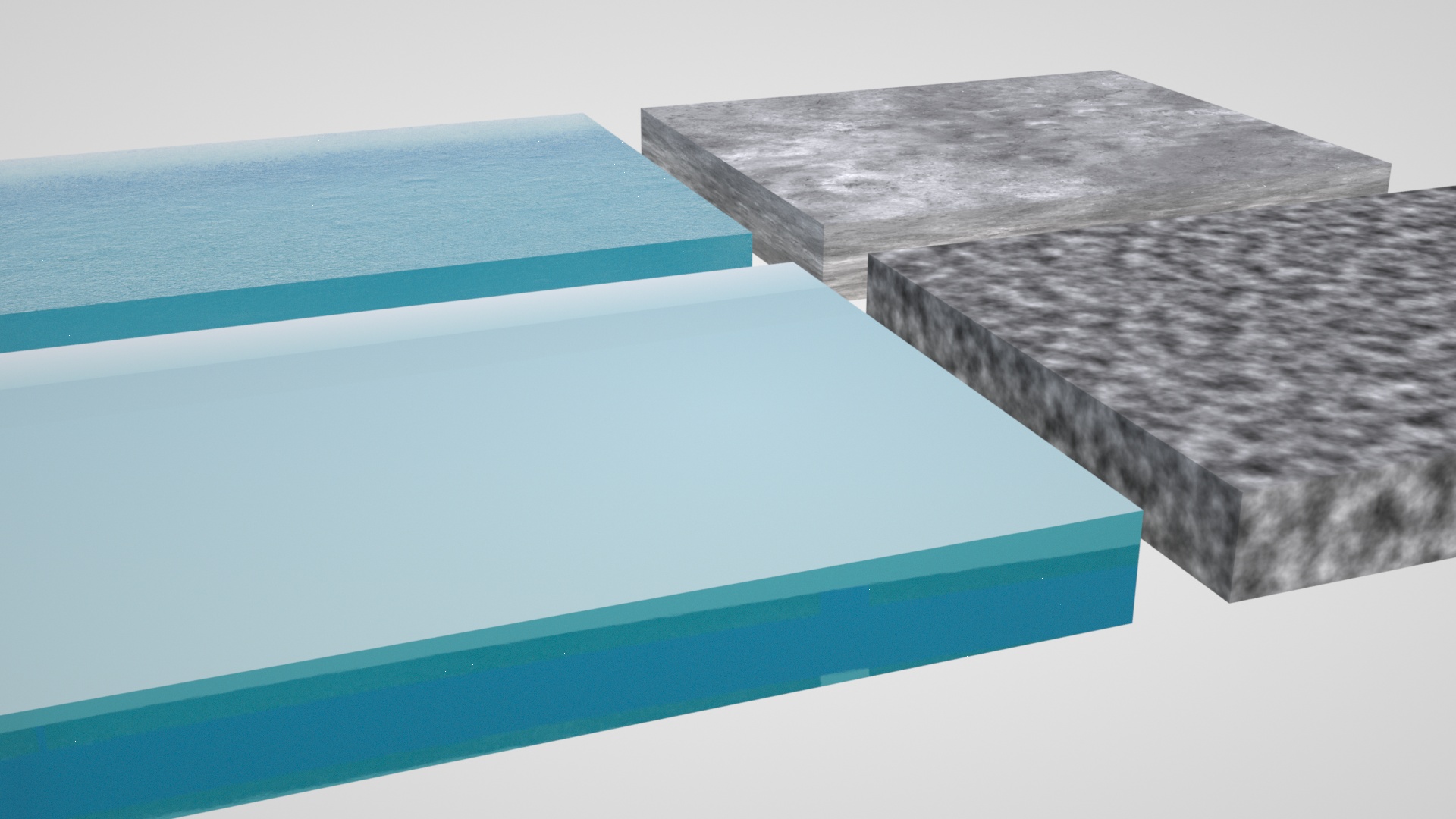

Here's another test to illustrate the point. I baked out the procedural map--that's the front row. The procedural map is the back row. You can see they match perfectly in the diffuse slot. You can see that the baked out image works as expected in the bump slot. The procedural map doesn't work as it should.

Hi senorpablo,
The noise works in the bump slot, but is barely visible in your scene.
It seems that with the scale 100 on the UVW transform, the output of the Noise texture need to be amplified. Here we inserted a Color correction that allows to have the bump effect visible:
BumpTest2.zip
(261.55 KiB) Downloaded 486 times
I hope that this will work for you.
