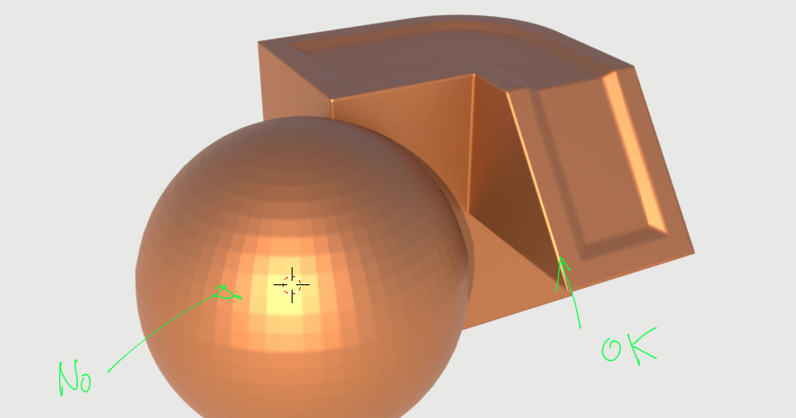

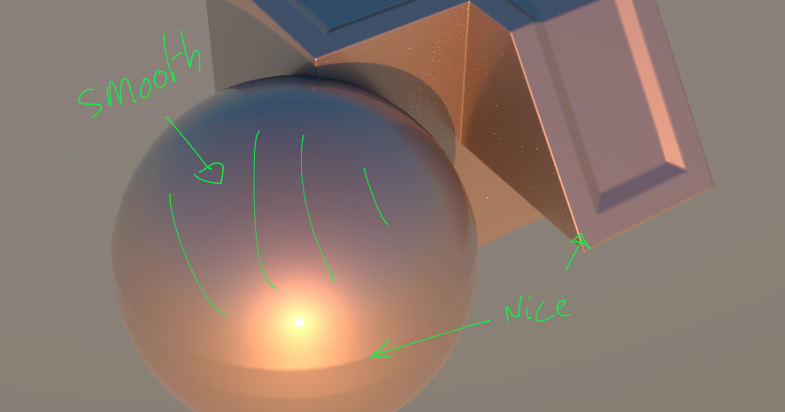

Hello Guys
I can't figure out the setup to make the rounded edge work in blender. i tried lot's of options and setup but never got it to work.
if i just export the model in obj with smoothing group and rendered it in standalone, it work perfectly out of the box.
I'm using the latest versions 2018.1 rc3.
In standalone:
Standalone render
Standalone render
best i got in blender with rounded edges:
Blender render
Blender render

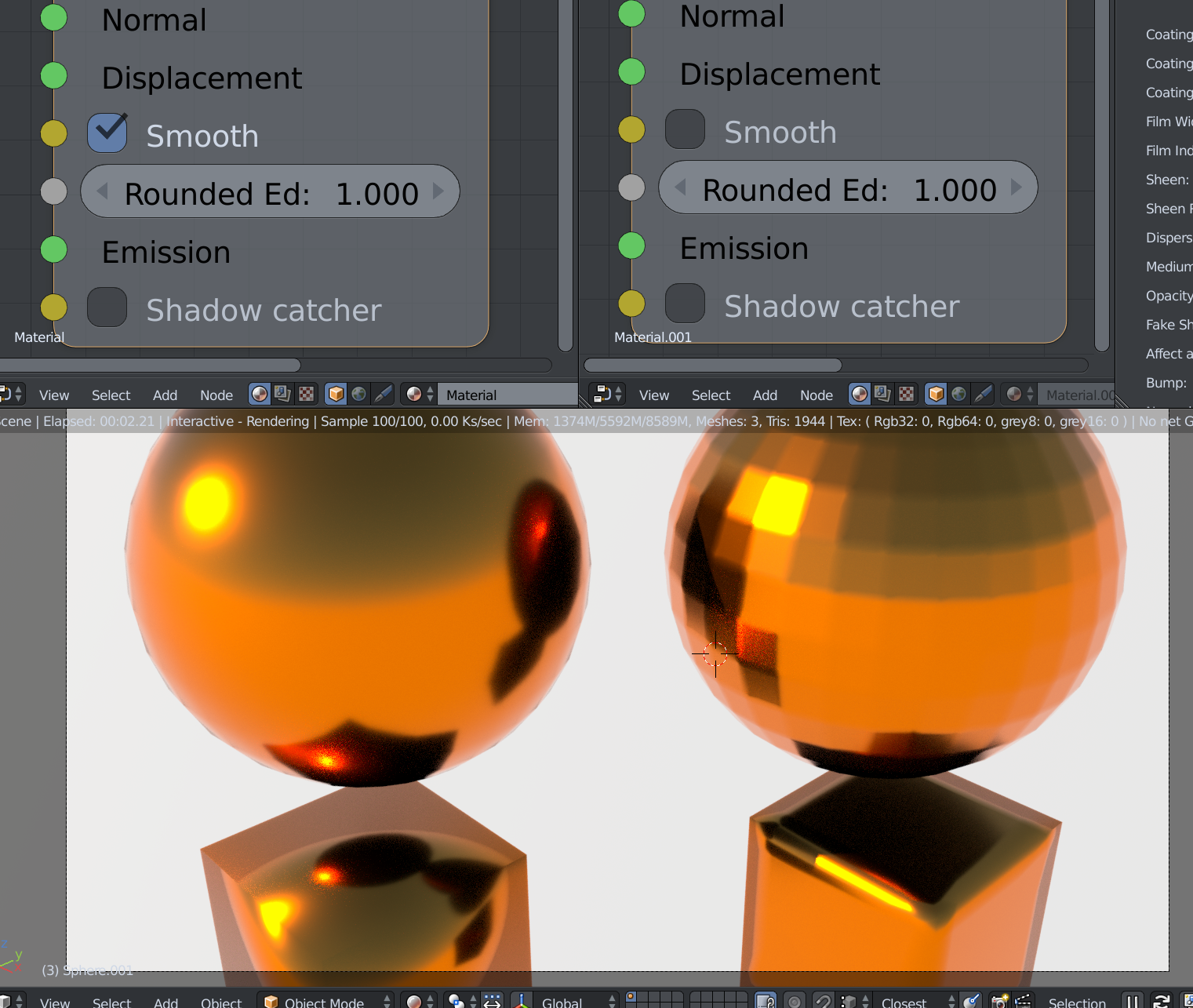

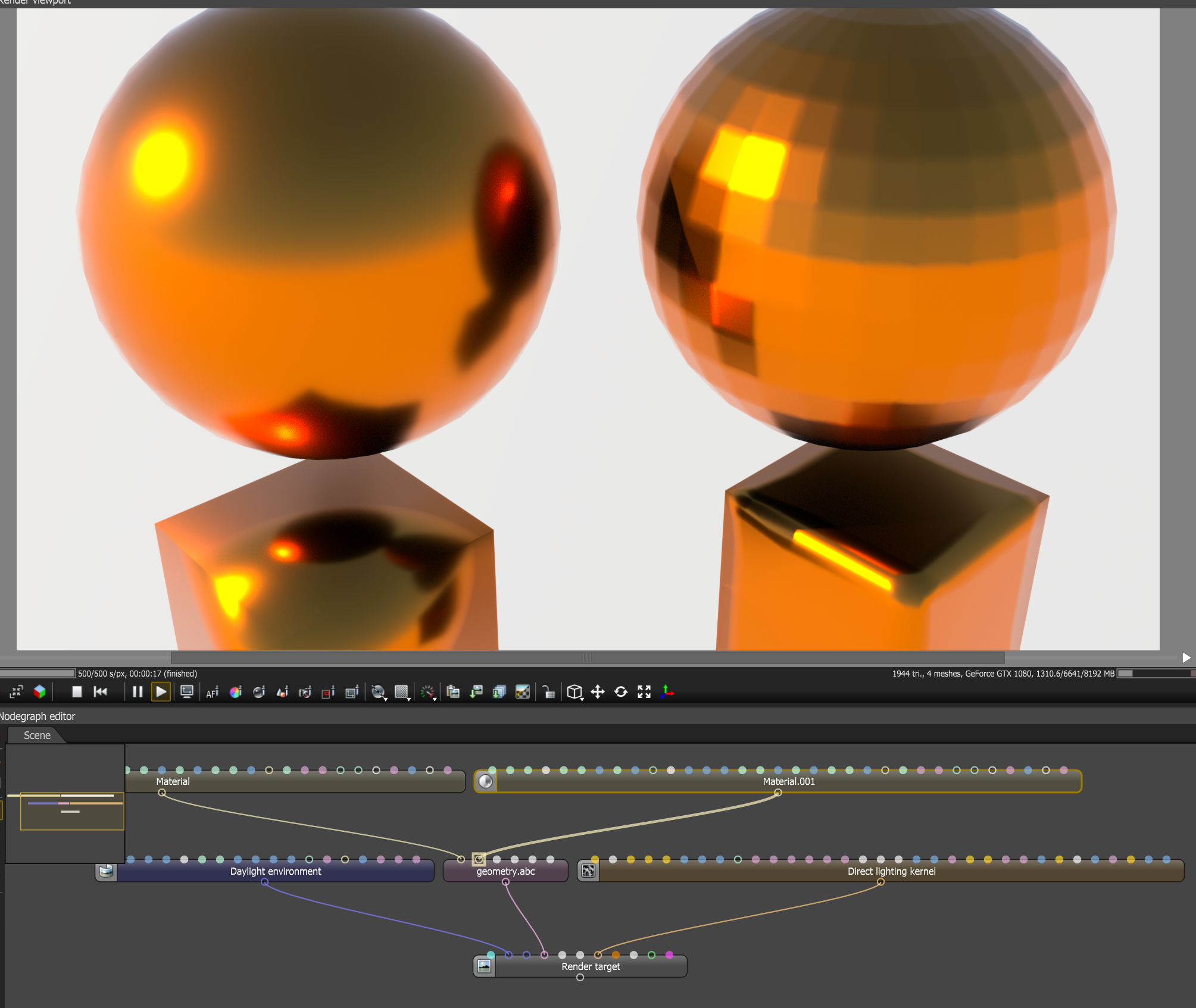

It seems that you can either have rounded edges OR Smooth shading (Smooth overrides Rounded Edges) and Rounded Edges don't care about the angles between faces.
Here's my test (and the difference in shader settings):
And the same scene in Octane Standalone:
It seems that you have two options:
  • Use different materials for different objects/meshes (one for Rounded Edges, one for Smooth)
  • Use a bevel modifier on the object (giving you control over which angles should be beveled)
NB: Rounded edges doesn't work with Auto Smooth.. :(
Windows 10 Pro - AMD Ryzen 7 2100X 8 core 3.70GHz - 32GB RAM - GeForce GTX 1080 8GB
Octane Prime - Blender Plugin user
Metal IOR values for Octane (with .blend library): https://chris.hindefjord.se/resources/rgb-ior-metals/
