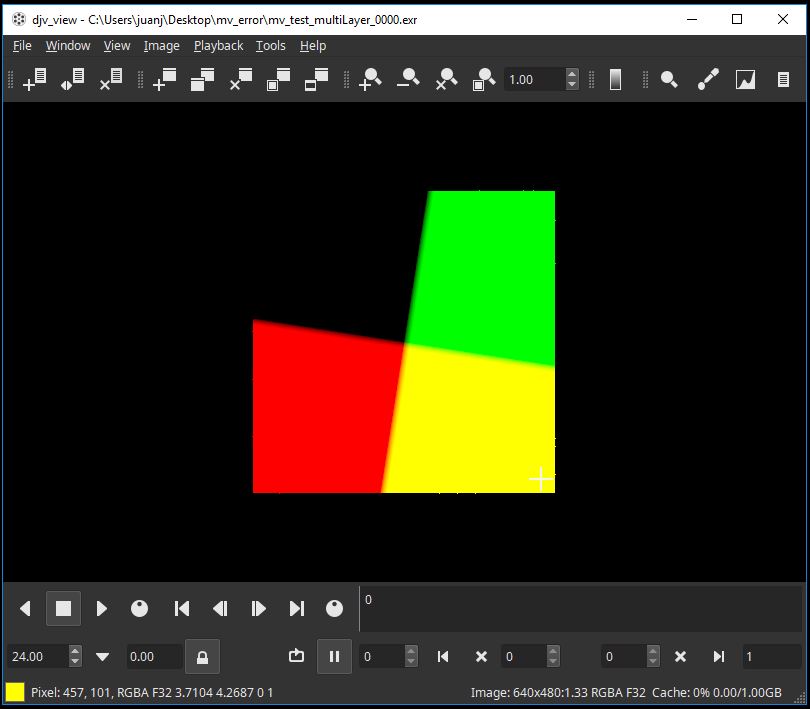

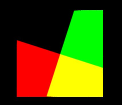

Hmm, I've been investigating this issue and your .exr file and the motion vectors are not wrong at all. The problem is that the display in the IPR is tonemapped, while the same image in any linear exr viewer is clipped to the 0..1 values, but the full float motion vectors values are there, as you can see in the attached image.
I wonder if you have some kind of workflow issue while you are applying the motion vectors. Could it be a problem of flipped vectors or something like that? I any case I'm fairly sure that the motion vectors in the .exr files are fine.
