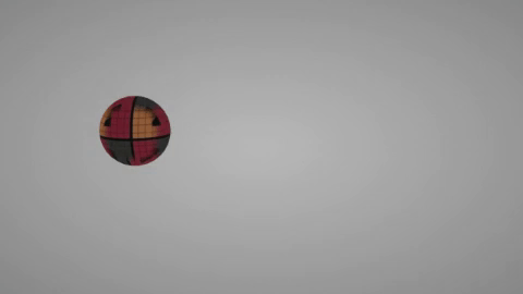

Hi
It looks like the triplanar Object space and worldspace coordinats is broken.
They both act the same unless i misunderstand how they are suppose to work.
This is how i think about it.
- You create a sphere in your 3ds max scene.
- You animate it from left to right.
- You apply a triplanar texture map to it and pick Object space.
This should make the texture stick/lock to the object.
- You now change it to worldspace
This should make the texture slide across the sphere because the sphere is animated.
At my end i get sliding on both systems.
UNLESS!!!!
I check the movable proxy on the sphere, then object space works as it should.
Is that intended? Do i really need to make all the objects containing this triplanar material to be movable proxy to make it work correctly?
They are both objectspace in the triplanar - But the first one is movable proxy and the second is not.
https://media.giphy.com/media/5UtdqOjGf ... /giphy.gif
https://media.giphy.com/media/WysDPT1Nq ... /giphy.gif
-Mats

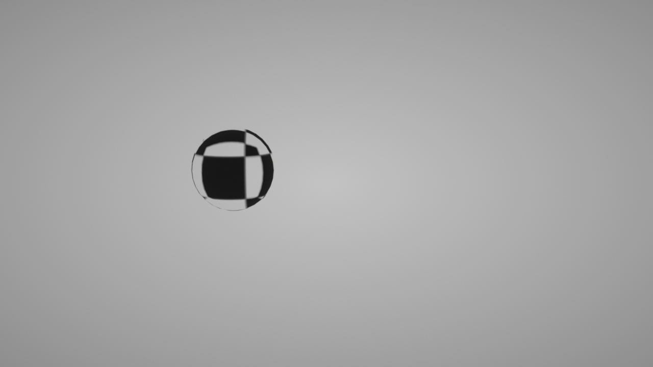

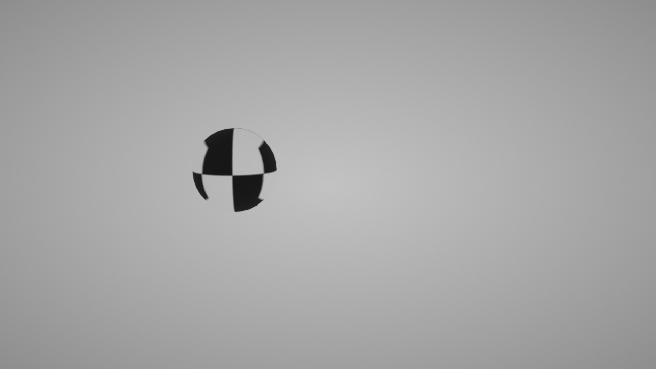

Here Paride
I have attached the maxfile in this post.
Here is the renders i made with this file, just for references to see if you get the same result.
Here is frame 0 and 5, the sphere DON'T have movable proxy on.
Here is frame 0 and 5, the sphere DO have movable proxy on.

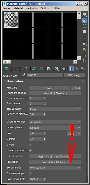

I have made a new test scene, this time i have based on this
https://docs.otoy.com/3DSMaxH/3DSMaxPlu ... narMap.htm
So we dont need to complicate it with maps, only colors.

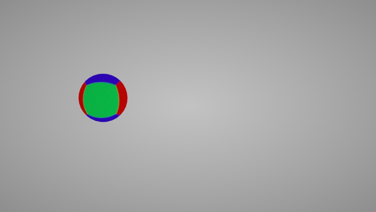

The results i get:
Movable proxy off
Movable proxy on
The sphere is here animated between frame 0 and 5 with a 90degree rotation in Z
And the triplanar shader is set to object space on all the renders.
I would really appreciate it if you had time to take a look on this maxfile aswell.
Thanks for the help
-Mats
It still doesn't work.
The results i get:
Movable proxy off
Movable proxy on
Thanks for the help
-Mats

Hi guys,
if you want to see the textures rotate coherently with the moving object, you must use movable proxy option.
you must use movable proxy option with all moving objects in the scene, and personally my advice is use movable proxy always and anyway.
A correct animation is object-space and movable proxy; if you want special effect you can use word or object space, but using projection node too.
Regards
Paride
Regards
Paride
