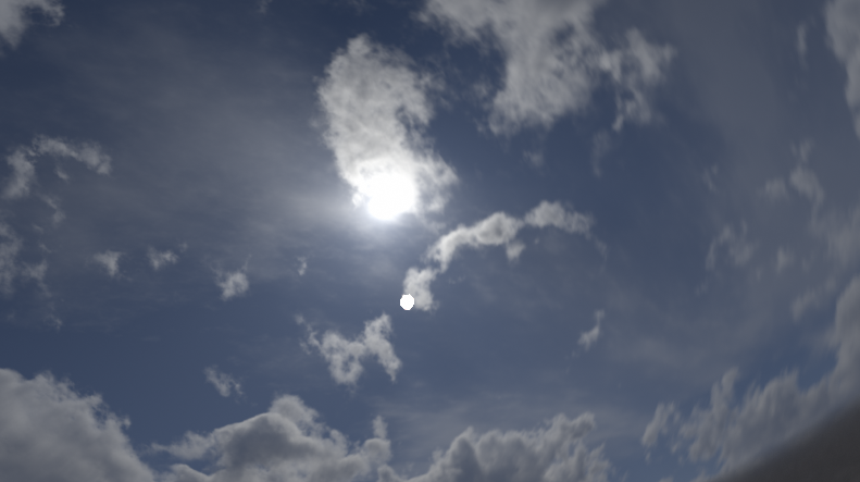

I am trying to sync my DayLight to my HDRI. So I rotated my light until it lined up with the sun of HDRI map.
I parented it to the Sky map object I synced it up perfectly, however, the more I rotatate the sky the more the sun looses its alignment and you start to see two suns again? The light seems to rotate at a faster rate than the HDRI.
NOTE: This only works if I restrict the rotation on the Y axis. When I rotate X, it looses sync.
This should not happen correct?
Two suns.
Two suns.

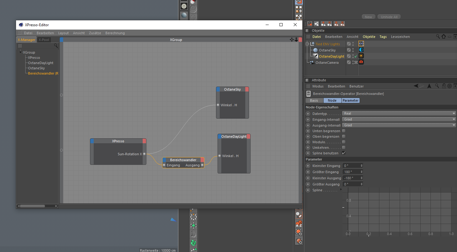

You need to tie the rotation of those light objects via Xpresso. I did it via H-coordinates of objects and not via north offset value in tags.
Example:

Ron wrote:You need to tie the rotation of those light objects via Xpresso. I did it via H-coordinates of objects and not via north offset value in tags.
Example:
Thanks! But could you translate those nodes?
Winkel. H = ?
I tried translating it but could not come up with anything other than "Corner".
I figured out the rest, I think.
www.alexdimella.com IG @alexdimella
Ron
Posts: 370
Joined: Sun Sep 25, 2011 7:11 pm
Winkel means Angle. It's the Rotation H.
I have attached my little solution that is doing the job for me. Maybe it is helpful for you or someone else.
I am using mostly HDRI from Darstellungsart where the sun is 180° opposite of daylight. In other cases the rotation H of the daylight needs to be adjusted accordingly.
Ron
Octaviz_Daylight_HDRI_Sync.zip
(6.06 MiB) Downloaded 132 times
