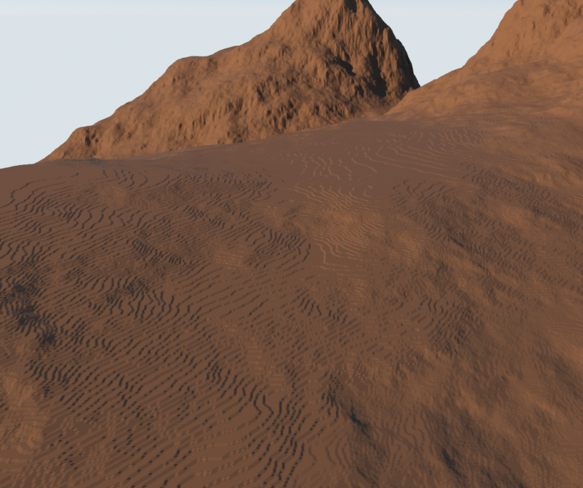

I'm exporting a 8K 32-bit TIFF height map out of world creator. Having it imported in cinema 4d and rendering it out with octane (displ settings 8K) i'm getting the results you can see in the attached image. If you look at the closest part of the mountain, you see a lot of artifacts. These are called 'banding' artifacts, and they are caused by using a image that has a bit-depth that is too low, for example an 8bit jpeg. However Like I said earlier, I'm using a 32bit TIFF. I tested this TIFF out on vray, and there it worked like a charm. All detail was perfectly visible and no banding. Any idea what's causing this in octane? I tested all kinds of other formats (RAW, EXR, PNG, etc) and even other bit depths. they all give me the same artifacts. With lower bit depth, the banding is worse (which is normal i think).

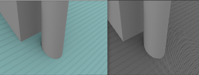

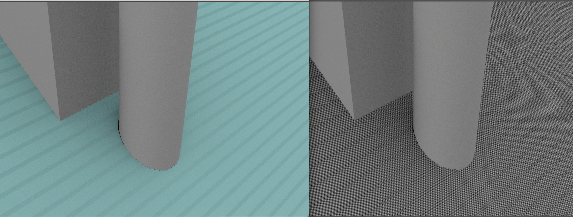

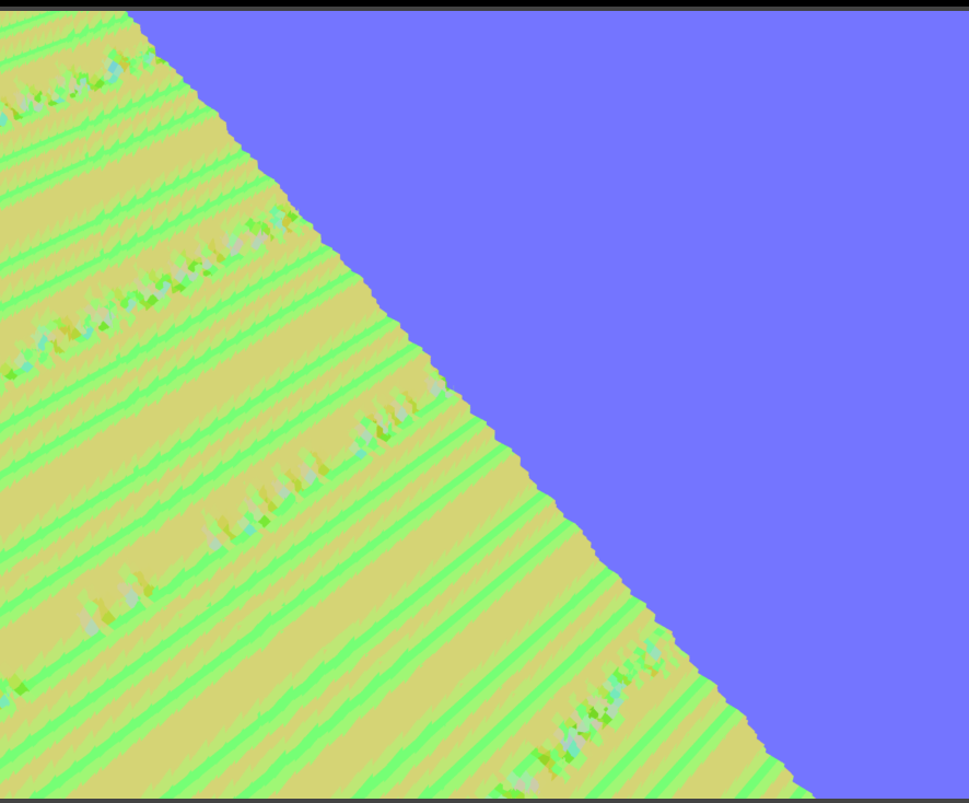

That example scene inspired me to dig deeper. I'm afraid I can't solve your problem, but after looking into it, I can share a bit of info that might lead the developers to a solution: The displaced geometry is fine, but the surface normals are way off.
Here's a quick test I just did in C4D R19, Octane 4.01.1-R2, using an 8k 32bit black to white linear ramp .TIF as the source displacement texture on a simple plain, with the Displacement Level of Detail also set to 8192. Notice that the actual geometry generated by the displacement is correct, but the surface normals are significantly lower resolution/sampling rate. I tested the surface res of these closeup images with an 8k black and white, single pixel per check, checker pattern (seen on the right) in the diffuse to be sure of the geometry resolution, as well. Click to see full size.
I hope that's helpful.

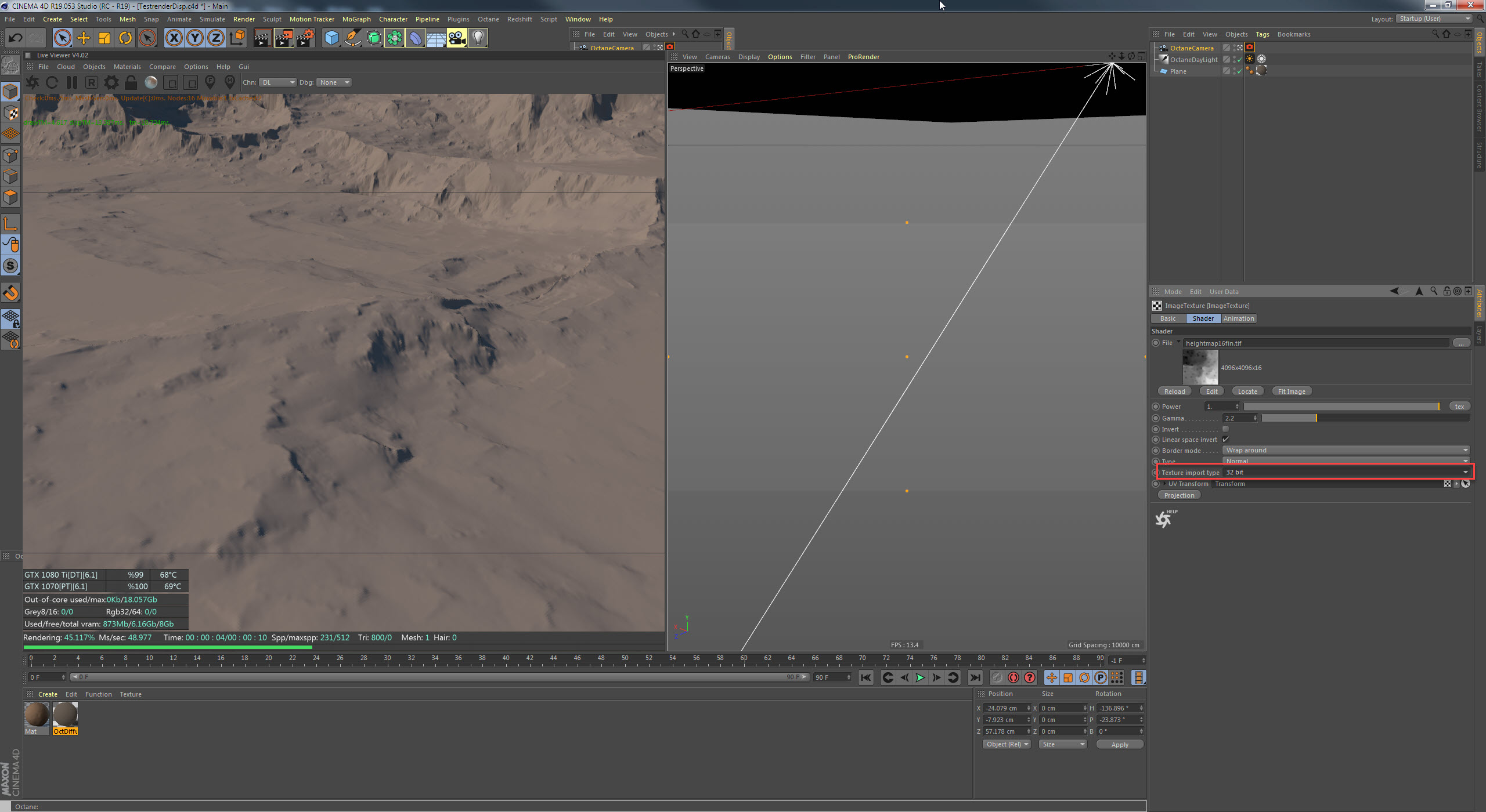

Also, there is no option ""texture import type" in my settings, see video in attachment (there I used a 32 bit 8k version of the file). There are 3 other options, but when I select one of them, Octane freezes (you will also see this behaviour on the video) Wich octane version do you use? I'm using 4.01.1.

Options you see, these are for 8bit images. As I said there's a wrong detection for grayscale tiff you use. I've fixed it for correct options for V4.02. Please check image again for LV's title text.Labrats wrote:Hi Aoktar,
