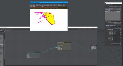

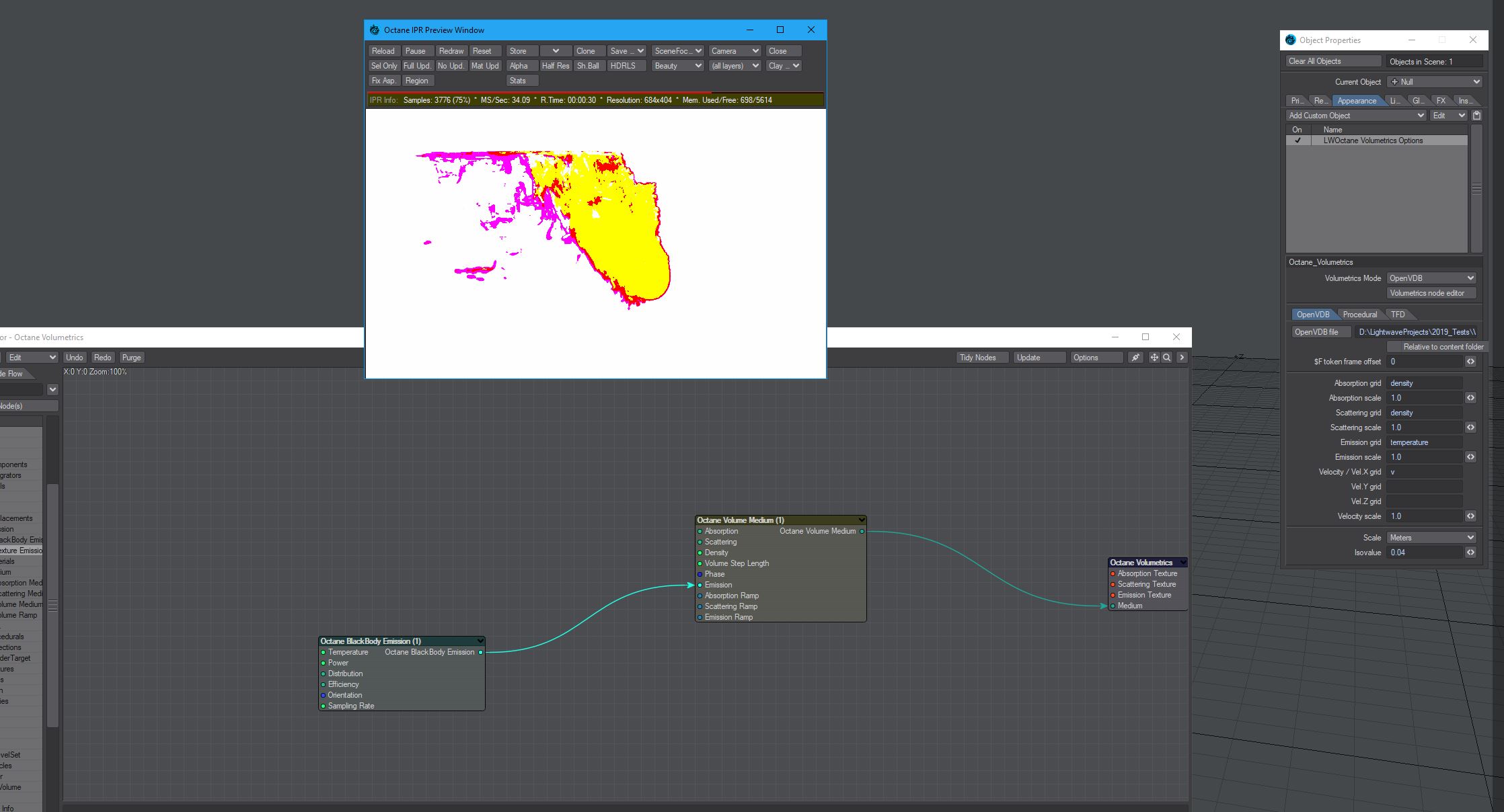

Just testing the latest version with Lightwave 2019. I've saved some VDB files from the new gas solver, but when I try to view them in Octane, the temperature channel doesn't seem to working right. I've tried lots of setting, but cannot get anything that looks good with the Blackbody radiator or texture emission. Anyone know what I need to do, to get this working? Thanks

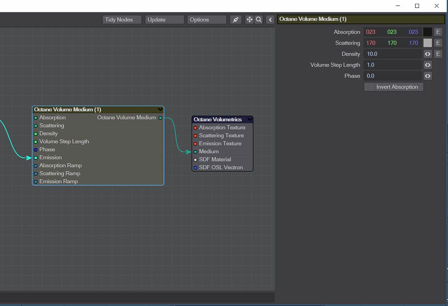

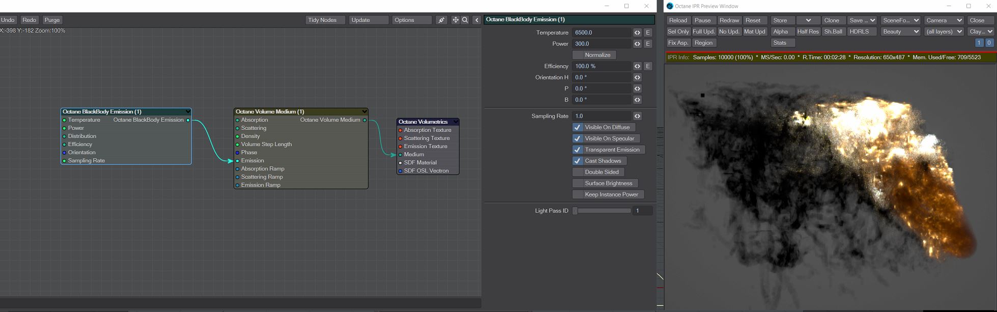

stevecullum wrote: Just testing the latest version with Lightwave 2019. I've saved some VDB files from the new gas solver, but when I try to view them in Octane, the temperature channel doesn't seem to working right. I've tried lots of setting, but cannot get anything that looks good with the Blackbody radiator or texture emission. Anyone know what I need to do, to get this working? Thanks
I suppose that it is a matter of configuring the right parameters in the emission and volume nodes. Check the attached images, that should help as a starting point. Also, remember that for volumes it is better to use the path tracing kernel.
