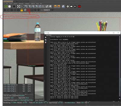

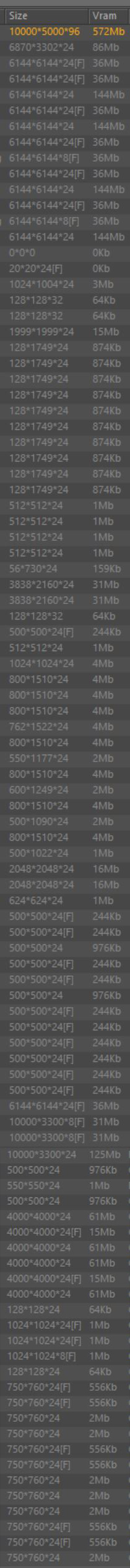

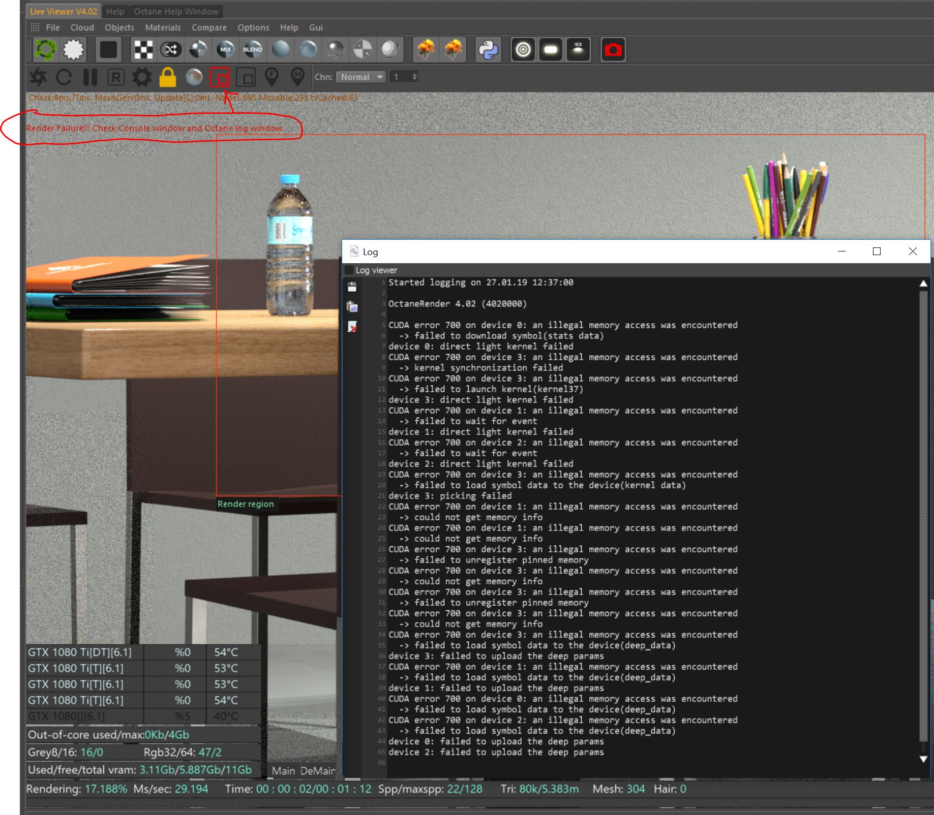

A little more than 8K see attached file of textures in the scene. The problem of CUDA error occurr as i try to select a render region on Live Viewer some time at first try or after some different selection (always on Loked resolution (6000x3375)
I have installed now 4.02 release of C4D plugin in R19 an try it but doesn't solve the problem but there are more information now on the error.
this scene has never given me problems before, I think it's a problem with the new releases of the program and plugins

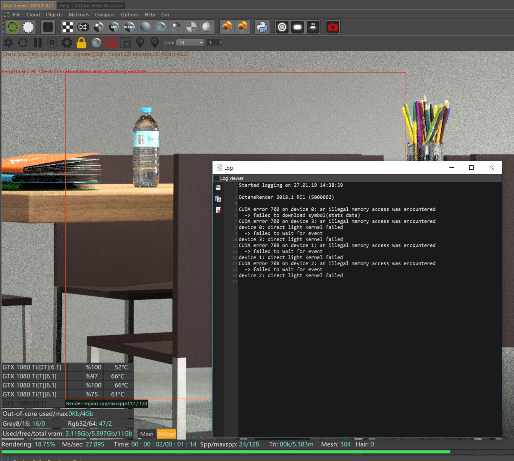

I have run some further test on the same scene with 3.08.5 NOT PROBLEM AT ALL and also on 2018.1-RC3 that crash immediately as I select a region on Locked resolution on LV. Same Cuda 700 error illegal memory access.
I am even more convinced there is a compatibility problem between the program / plugin and new video dirver.
I have observed that as I select "lock resolution" on LV on 3.08.5 the image change almost immediately, instead on 4.02 or 2018.1-RC1 is letagic it needs al least 6-10 seconds, then it may crash immediately or after one or two different region selection. :twisted:
