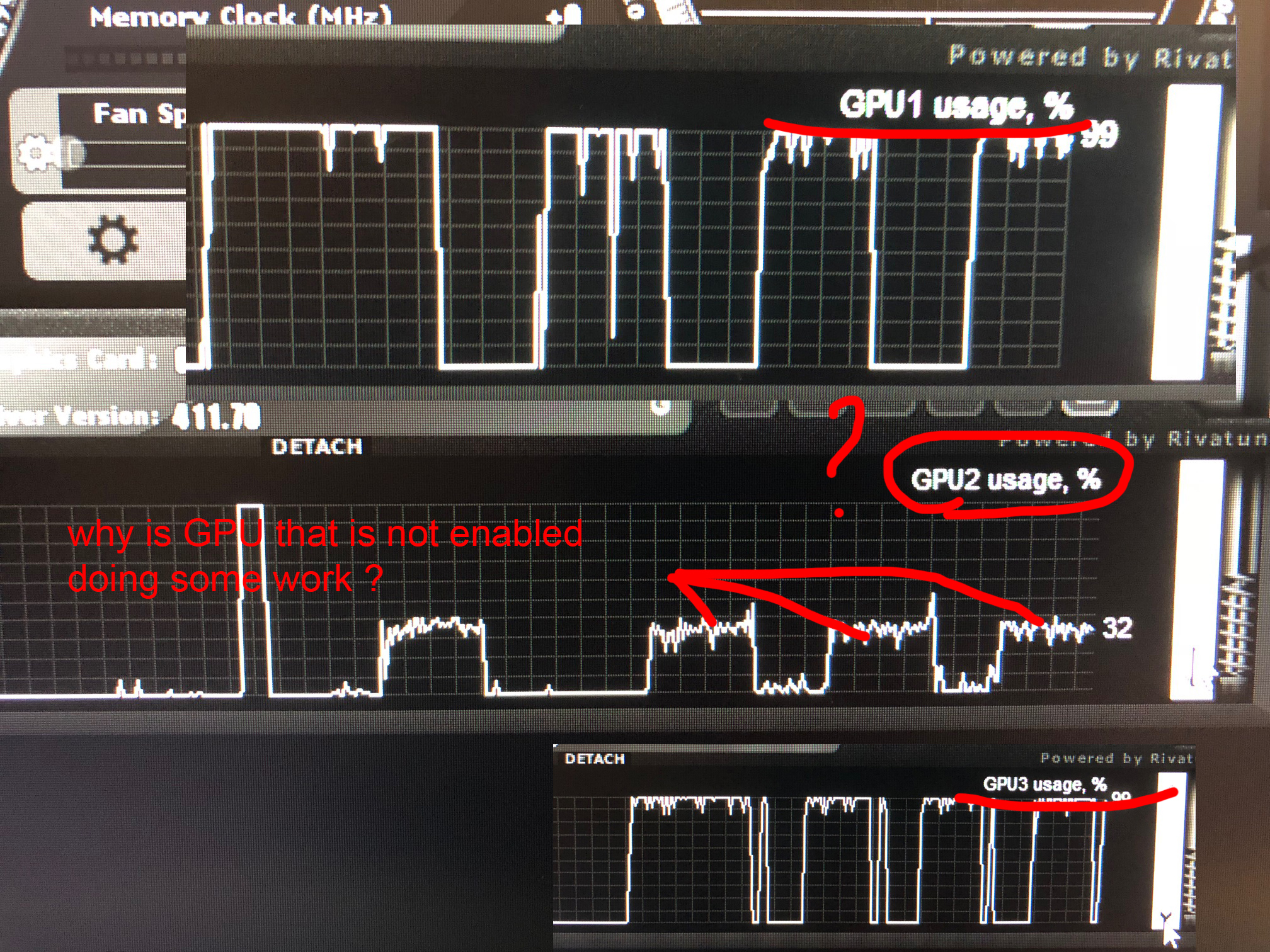

coilbook
Posts: 3091
Hi Otoy,
why is my GPU rendering when it is not enabled in octane? It happens when out of core is used. Thanks
