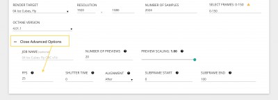

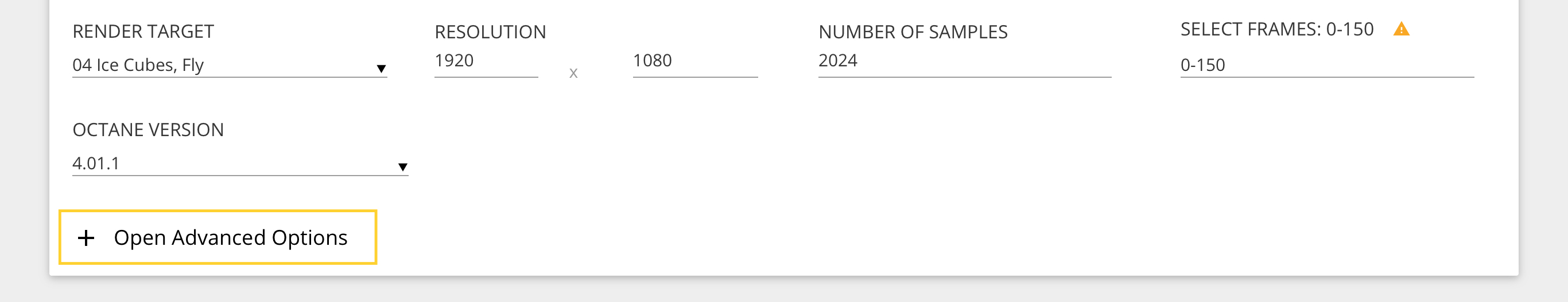

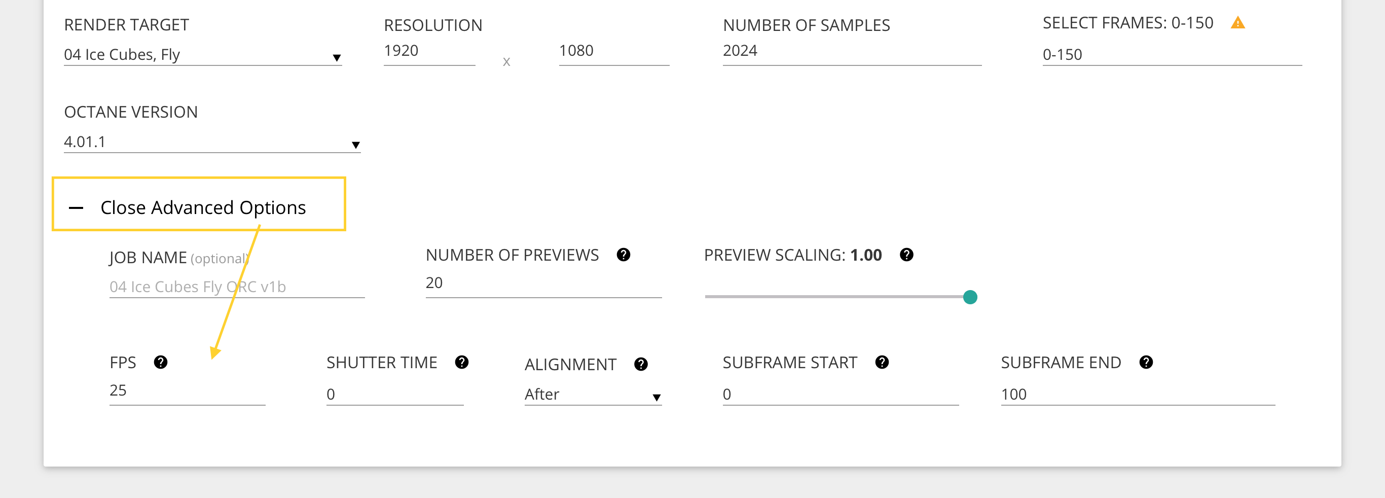

you can always set your render target in Standalone, anyway, while preparing the scene on ORC, if you click on the Open Advanced Options button:
You can change FPS and other settings:
