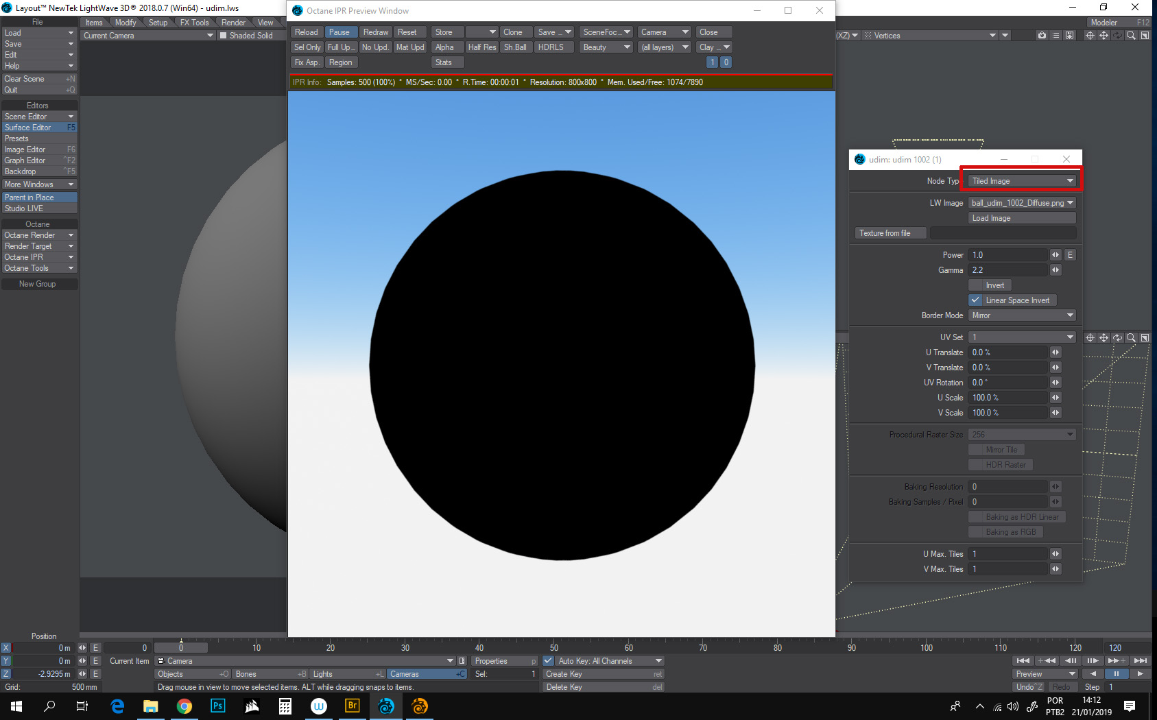

Hi, I searched for UDIM workflow and didnt find anything in LW. In the texture node, I changed the node type to tiled image, but I everything black. I am using octane 2018.1.
I am attaching a simple scene with a ball with two udims, and two images. These images were made in Substance Painter, and they are seamless.
Someone found how to use UDIMS?
Thanks in advance,
Saulo

The support of UDIM and UVTILED textures in the texture image node works adding the <udim> or <uvtile> tags to the "Texture from file" parameter, for example "myTexture_<udim>.jpg"
