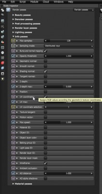

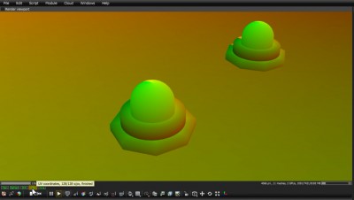

you need to connect the InfoChannel kernel node to the render target node connected to the mesh geometry to be checked.
Or simply click the Kernel icon in the Node Inspector, then switch it into InfoChannel.

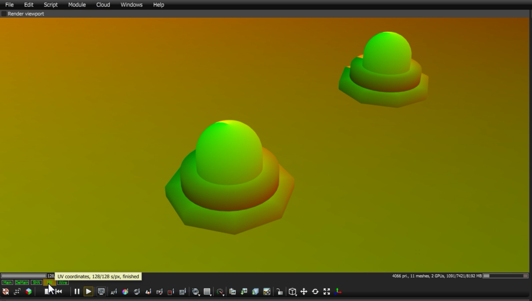

Alternatively, you can enable the Info passes/UV coordinates pass, and click on the button in viewport, without switching the kernel.
ciao Beppe

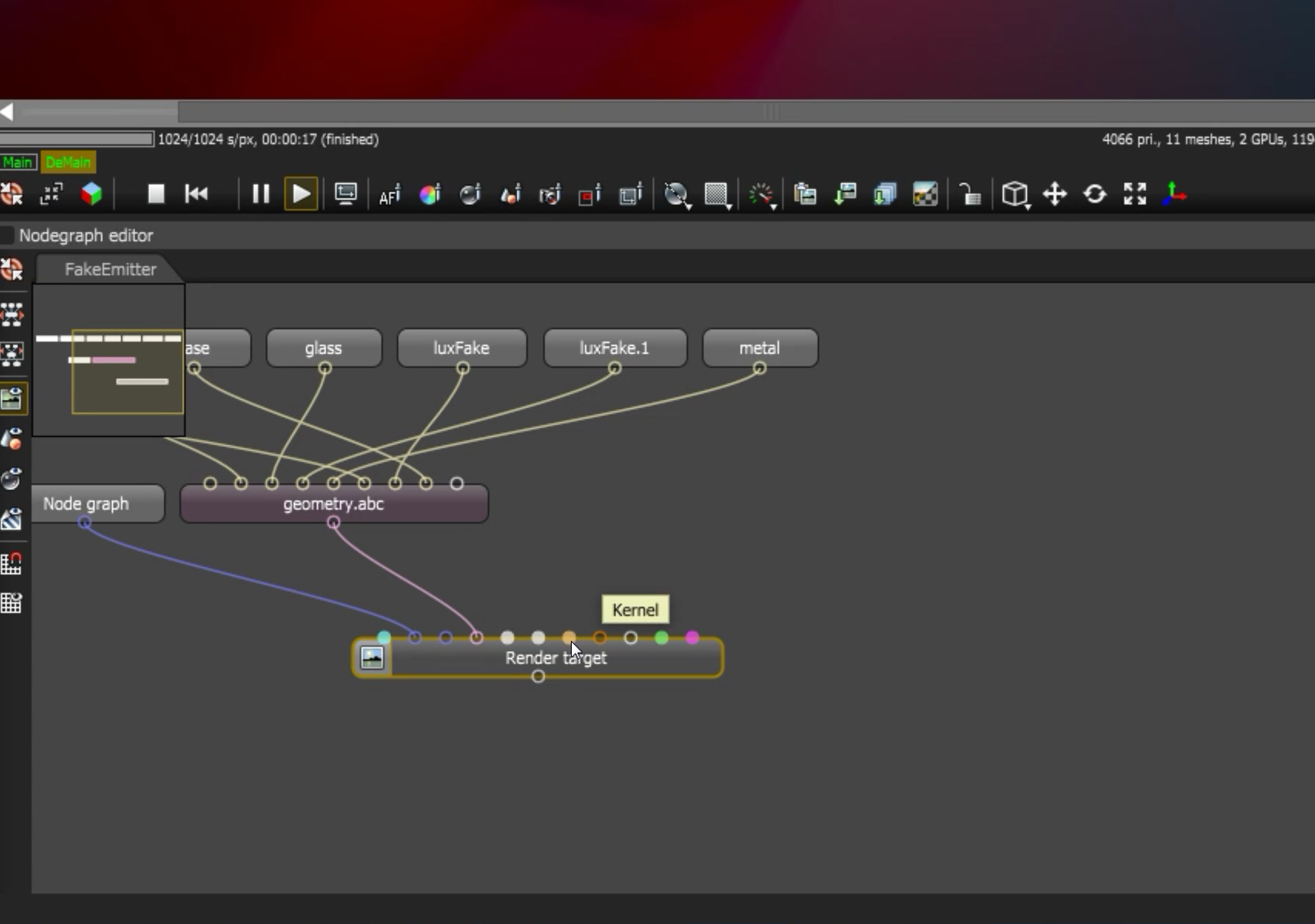

OctaneRender has four different kernels, Direct Light, Path Tracing, PMC (rendering kernels), and finally InfoChannel (visual information about the scene) .
Any Render Target node can have the kernel node inside the pin, or connected to the kernel pin as external node.
If no Kernel node is connected, or is not present inside the Render Target kernel pin, and the pin is empty, the scene is rendered in InfoChannel Wireframe mode, by default.
ciao Beppe
ciao Beppe

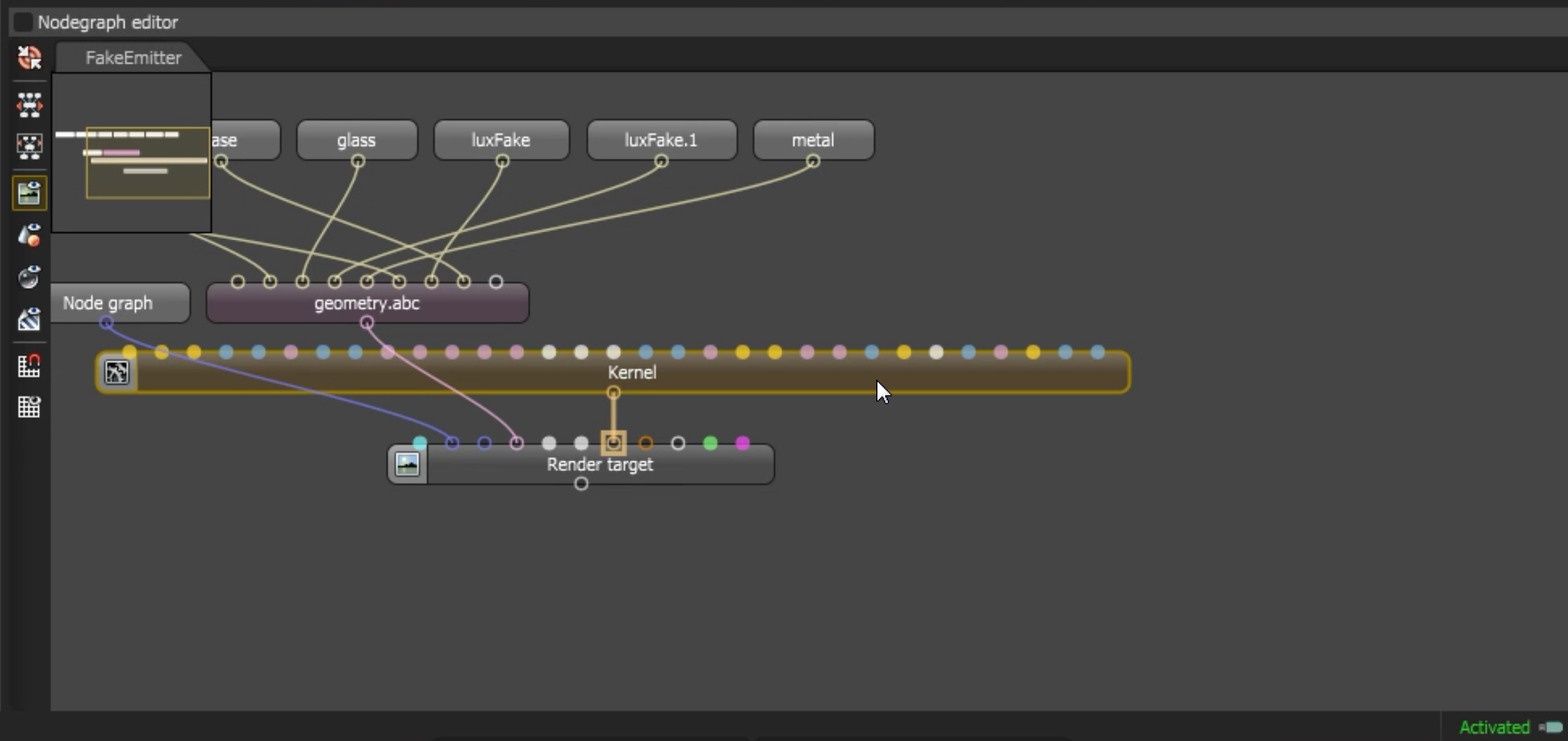

Beppe, what do you mean by this;bepeg4d wrote:Hi,
ciao Beppe
and this;Any Render Target node can have the kernel node inside the pin, or connected to the kernel pin as external node

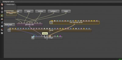

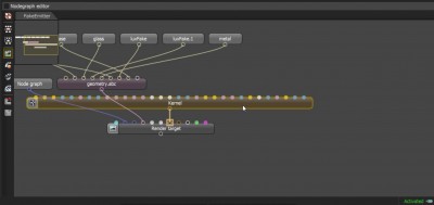

Any Render Target node can have the kernel node inside the pin (Collapsed):
or connected to the kernel pin as external node (Expanded):
so you can connect a different Kernel node, without losing the original node:
Alternatively, you can enable the Info passes/UV coordinates pass:
and click on the button in viewport, without switching the kernel:
ciao Beppe
