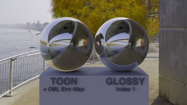

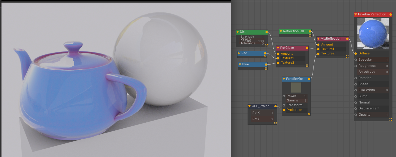

We can do that now using OSL projection. (There's another way to do this--as a OSL Texture--but this way you don't have to worry about file paths)
I'll make a separate topic for this because there are a few more variations I want to post but for now check out this C4D file. I used toon shader but you can also use it in emission.
ReflectionMapProjection.zip
(4.49 MiB) Downloaded 278 times
edit: I just noticed I left in there a mysterious Reinhard.cube LUT in the tex folder. It's made for Camera Imager and the only clue on how to use it is this: 0.03125 and 5. :ugeek:
