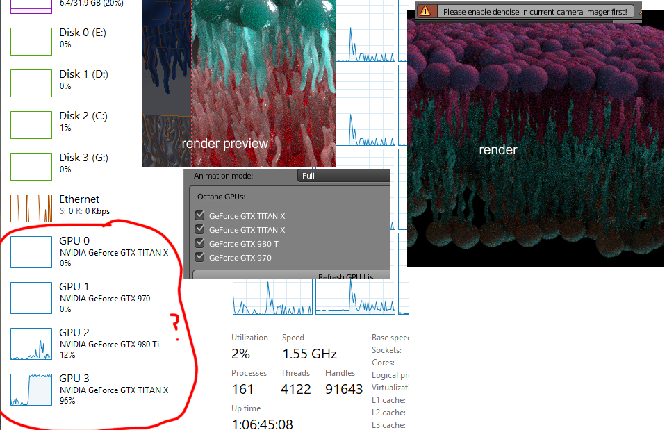

With no priority selected, you will see that I have a very strange activity spread between my GPUs. Really only 1 GPU at work. This is for both the Preview and the Render.
When the Preview Render finishes, it looks correct, and denoised (denoise not shown as I wanted to capture the GPU information in action).
Why is there almost no GPU activity on 3 of my GPUs? (see lower image)

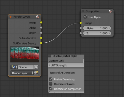

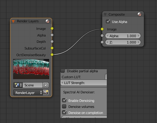

Separately, and this may be a bug: When Rendering (not preview) the message "Please enable denoise in current camera imager first!" flashes. I do have it enabled in the Spectral AI Denoiser panel..(see upper image).

did you switch your GPU's usage to compute mode in task manager?
If "Please enable denoise in current camera imager first!" appears you probably have a enoiser pass enabled while it is not enabled in Camera Imager settings.

I did nothing in the Task Manager, other than look at the graphs. I don't see any settings to control there regarding any settings. Only the ability to observe.
Are you saying I am supposed to switch my GPUs to compute mode?
And I am only really seeing 1 GPU at work during the render.

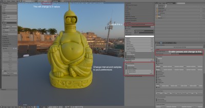

To use denoiser in preview you need to enable denoiser in Camera imager preview, lower the interval, adjust denoiser samples, uncheck denoise at completion... then enable preview pass type in passess to Denoiser Beauty.protovu wrote:J.C.,
Separately, is there a way to enable denoise/beauty in Preview? And a way to toggle it on and off?
Thank you,
Rick
The information on those settings:
https://docs.otoy.com/StandaloneH_STA/S ... noiser.htm

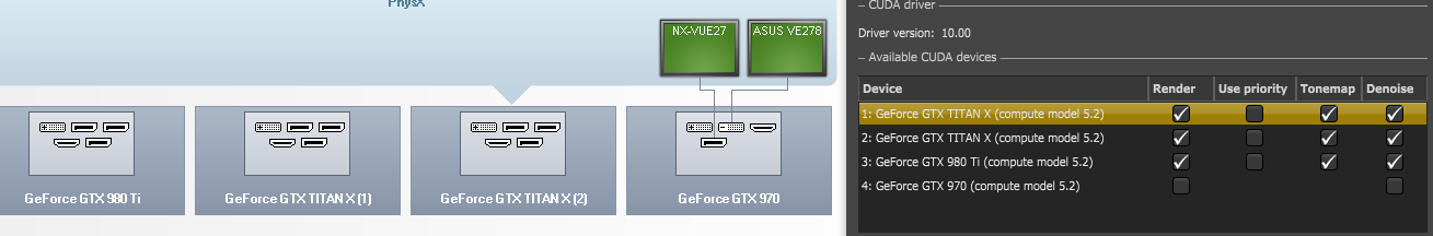

Hi Rick
What's your system configuration? What octane plugin version are out using?
To see more what's going on there is an Octane log window below the devices settings.
The best practice in using GPUs is to use one that drives the monitor and the rest assign to octane.
If you want to use all devices you may accounter less system responsiveness and freezes. You can also change the render priority to a selected device so it won't work at full speed.

Thank you for thew best practices information. I will give it a try. Does the attached look correct?
Computer seems pretty slow even typing this message.
My system:
Win10 64bit
Dual Xeon
32 GB RAM
GeForce...GTX 970, 980ti , 2 x Titan X's
