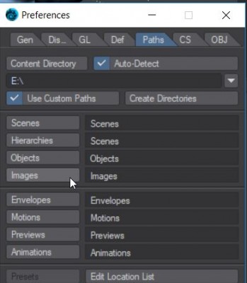

liveDB materials are great, but "it" download the textures in the desktop, or sometimes in desktop/assets/, or desktop/textures/
This means that my desktop becomes a mess.
There is a way to force liveDB to put the textures in a specific folder?
In the manual there is a phrase: "The texture maps are downloaded and stored in the project images folder, including support of map file names relative to the current projects image folder."... but this has no sense to me, what is the "project images folder"?

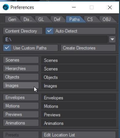

Yes, the liveDB textures are stored by the plugin in your project "Images" folder. This is the images content path defined in the project Paths preferences.
