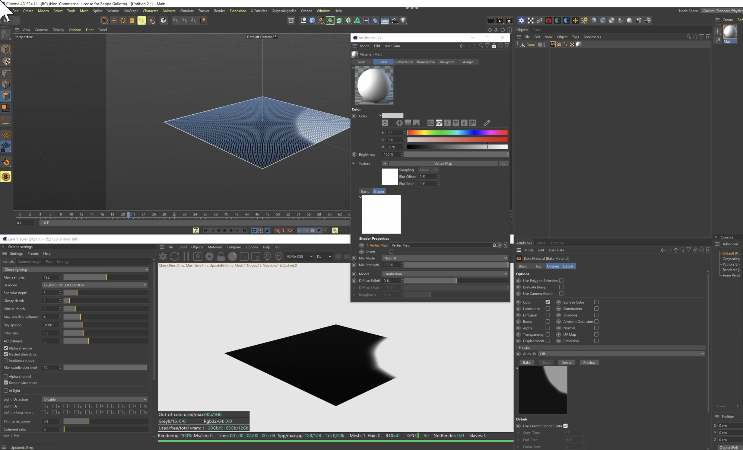

How did you manage to bake Vertex map animation in Cinema4D? I cannot figure out a way to do just that since R19 to R25... Do I have to bake it in Alembic?

you can use the Vertex map shader in a simple c4d material, in color channel, then use the c4d Bake material tag to bake the animated sequence:
