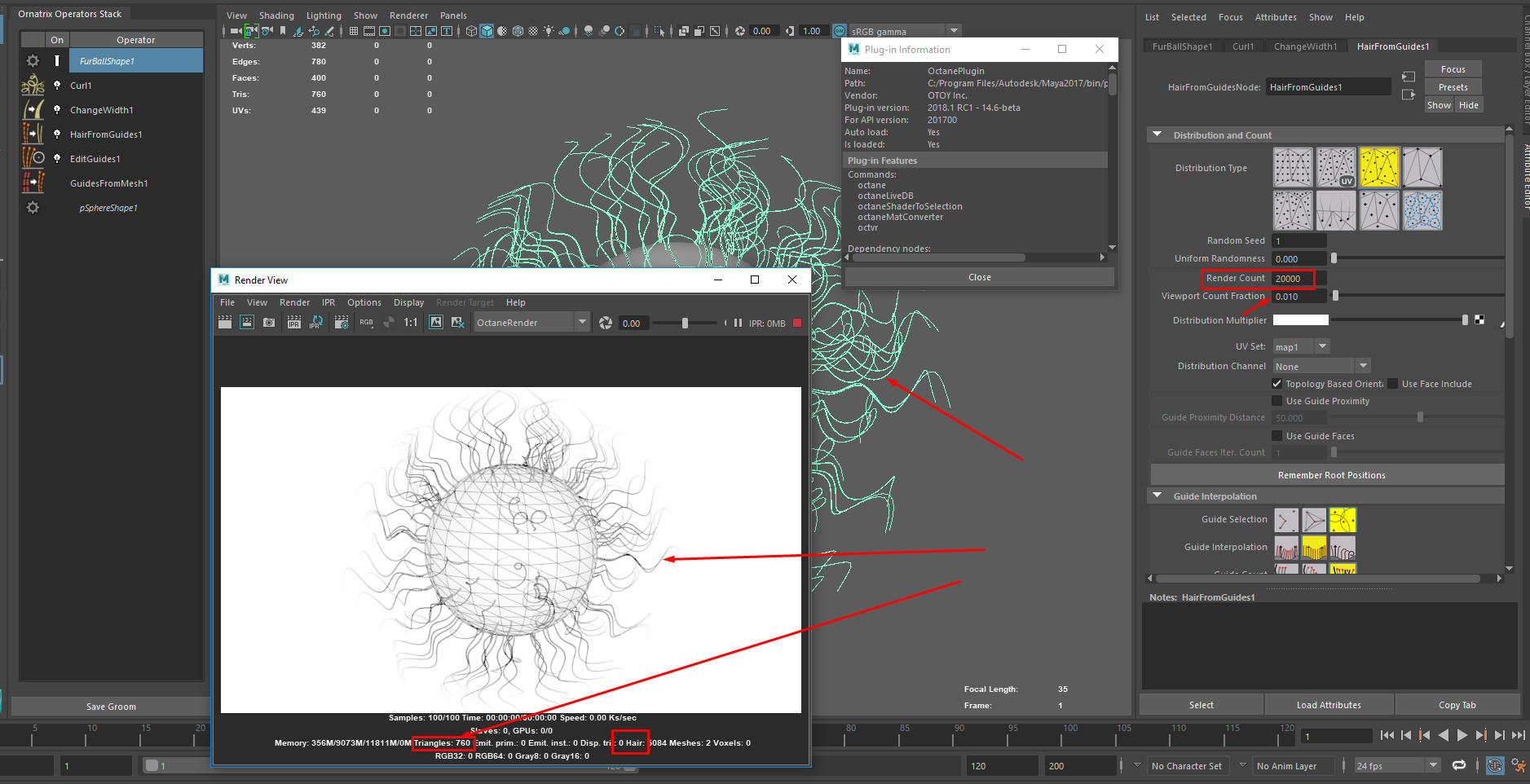

Hi Jim,
Happy new year! Hope everything is fine. I have a problem to make work Ornatrix simple scene with sphere is not load as hairs but as Mesh also is not supporting the render hair option to see on viewport less and on the render more (the all reason of the plug) Please any help maybe I set wrong here a screen shot . I can't save the scene cause of demonstration version, but I'm sure you could build one simple sphere scene.
Cheers,
JO
Screen shot
Screen shot

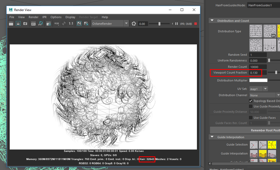

Hi Jim,
After further test is working but, is a information issue, show "0" hair but after change the "viewport count fraction" while I'm doing the IPR is showing right amount.
The only issue is Render count is ignored and Octane use only the viewport preview count. I think we need make sure is using the Render count not the viewport count fraction preview.
Cheers,
JO

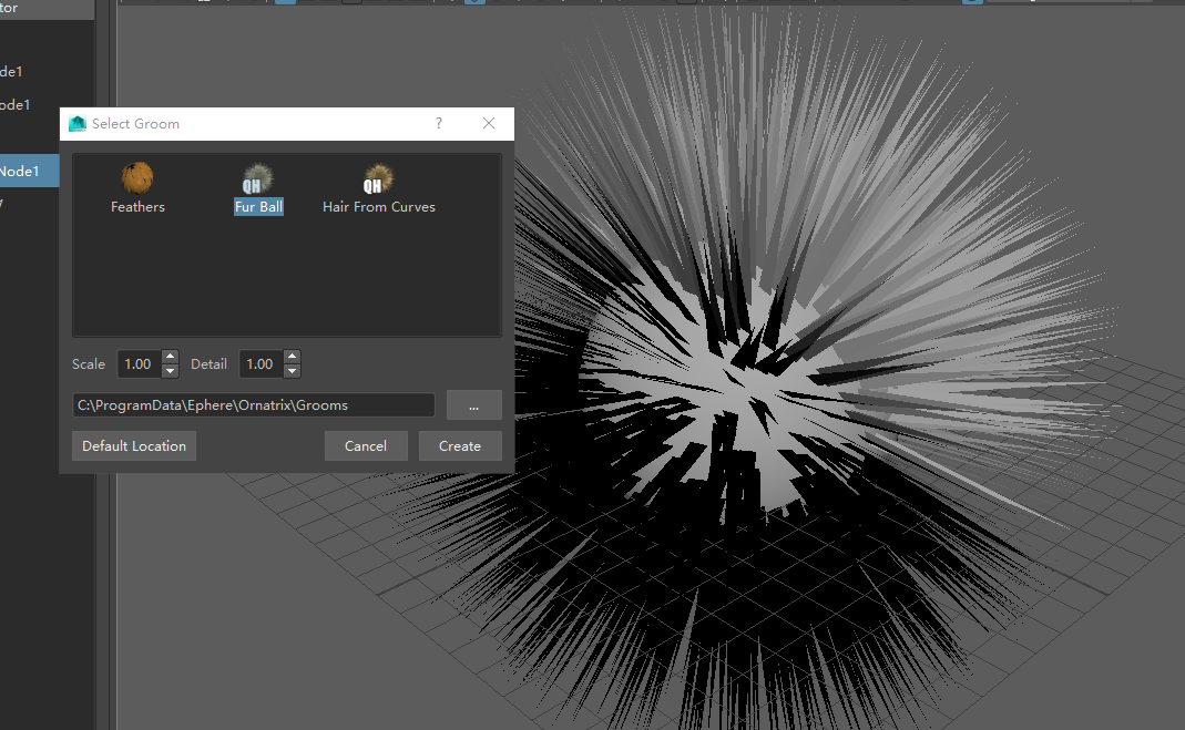

Maya 2016 crashed in OCrendering when add a Ornatrix fur ball to poly allways.

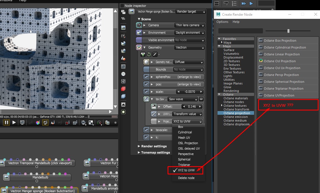

Hi Jim,
I'm using vectron on the Maya Plug I manage to make work really well, (apart the scale options is a bit weird with the dummy box which doesn't have the mesh size like a bounding box, old request for all proxy, vdb's and etc.)
I have a problem to replicate the example scenes from Standalone one projection node is missing the XYZ to UVW node.
(I know I could just copy the nodes via orbx proxy and I have on the scene but if want build from scratch I don't know how to)
I included the scene "octaneOslGeometry1" I try to build from scratch and "the proxy" is from standalone. Please help me if I did something wrong.
Here a screen shot:
Cheers,
JO
vectron_test_Box.rar
Scene
(13.04 KiB) Downloaded 220 times

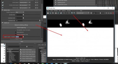

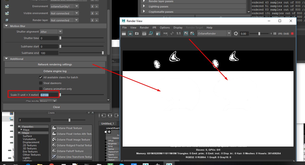

SDF Vdb mesh, is not supported on real size world based on the most common workflow on the industry using Maya units at centimeters, cause Octane is on "meters" we need set scene scale at "0.01" to work right? I guess I need ask Standalone not sure if I can have a object at "50cm" size doesn't work. Is the same issue we had before with displacement (fixed now). When I checked the RC1 version only big object like "50 meters :o " size is rendering correct with SDF, and this on my point of view break all the concept sold by Otoy's physically based render if real size world is not properly supported. (I guess is just this feature due the Beta stage)
Anyway Maya plug as this issues for while. I post some screen shots from Maya Plug, but I think may be a Standalone issue because if I create a SDF at 50 unit 1unit=1 metter is fine but if I create at 0.5 unit = 50 cm doesn't work as well on the standalone.
Please can we have any clarification on this?
Thanks :),
JO
Scene scale at 1
Scene scale at 1
Scene scale at 0.01
Scene scale at 0.01
