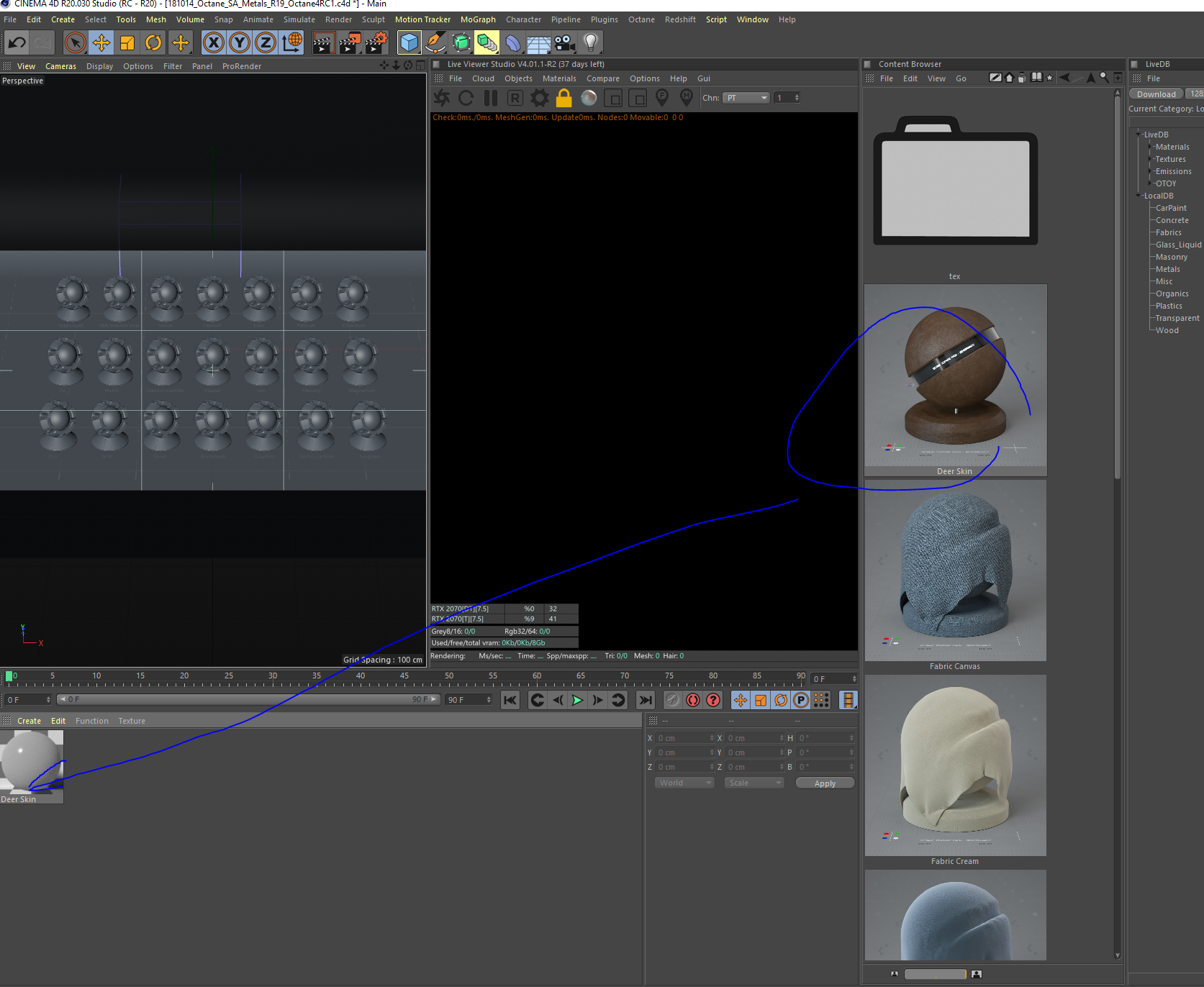

I downloaded a material pack as a .lib file but when I try to put the material to use, nothing links over. (See image). Not sure what I'm doing incorrectly. I'm on the latest octane version and r20.

Used materials with mix materials that will be broken/missing in content browser. Limitation! Blend material is for fixing this or more issues.

I believe they are already blend materials, I will upload a screenshot when back at home. Also I have the issue of texture previews not showing up on nodes. I've made sure that node previews was checked.
