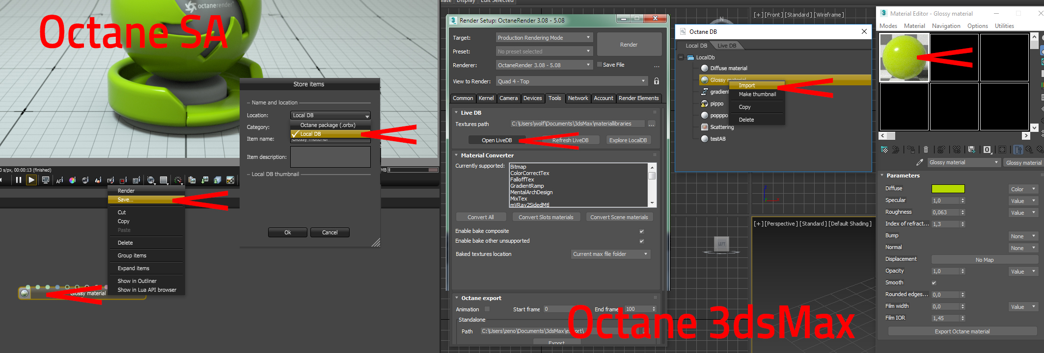

is it possible ?
anybody can explain how to use local db in max ?

Hi HHbomb,
We have use LocalDB workflow to import Octane materials into 3dsMax, at the present time.
Regards
Paride
HHbomb
Posts: 1407
Thanks Paride, but when saving from SA , in 3dsmax local DB is empty, so nothing to import.
paride4331
Posts: 3919
Hi HHbomb,
Have to set same path:
C:\Users\(user)\AppData\Roaming\OctaneRender\localDb
Regards
Paride
HHbomb
Posts: 1407
Thanks. I thought we can create a custom live db folder, but it seems to not working.
When I use your path it works fine ! Thanks
paride4331
Posts: 3919
HHbomb wrote:Thanks. I thought we can create a custom live db folder, but it seems to not working.
Hi HHbomb,
you can create a custom Octane textures folder.
Regards
Paride
