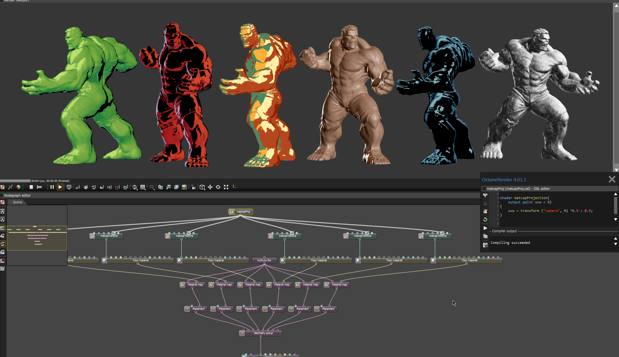

simple OSL projection node for matcap textures used in toon material.
Code: Select all
shader matcapProjection(
    output point uvw = 0)
	uvw = transform ("camera", N) *0.5 + 0.5;
Matcap_demo.orbx
(4.38 MiB) Downloaded 649 times

Great work. Thank you.

Thanks!
Was looking for this OSL to make matcap to work with Octane!
Nice shaders too!

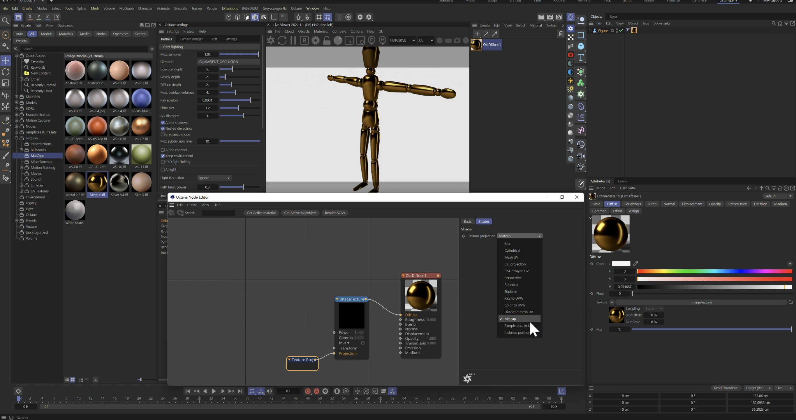

Hi Kalua,
Matcap projection is already available from a long time, no need to use an OSL projection node anymore:
ciao,
Beppe
