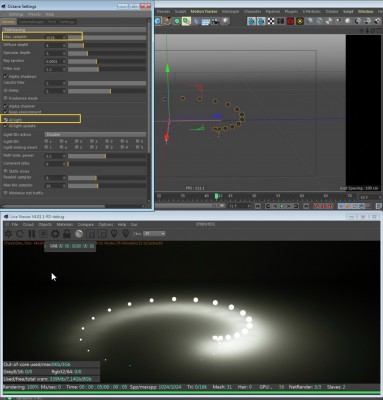

About the specific scene, the Kernel settings are not optimized.
For example in v4, you can reduce the Max Sampling at 1024, and enable AI Light, the rendering should be much faster: ciao Beppe
