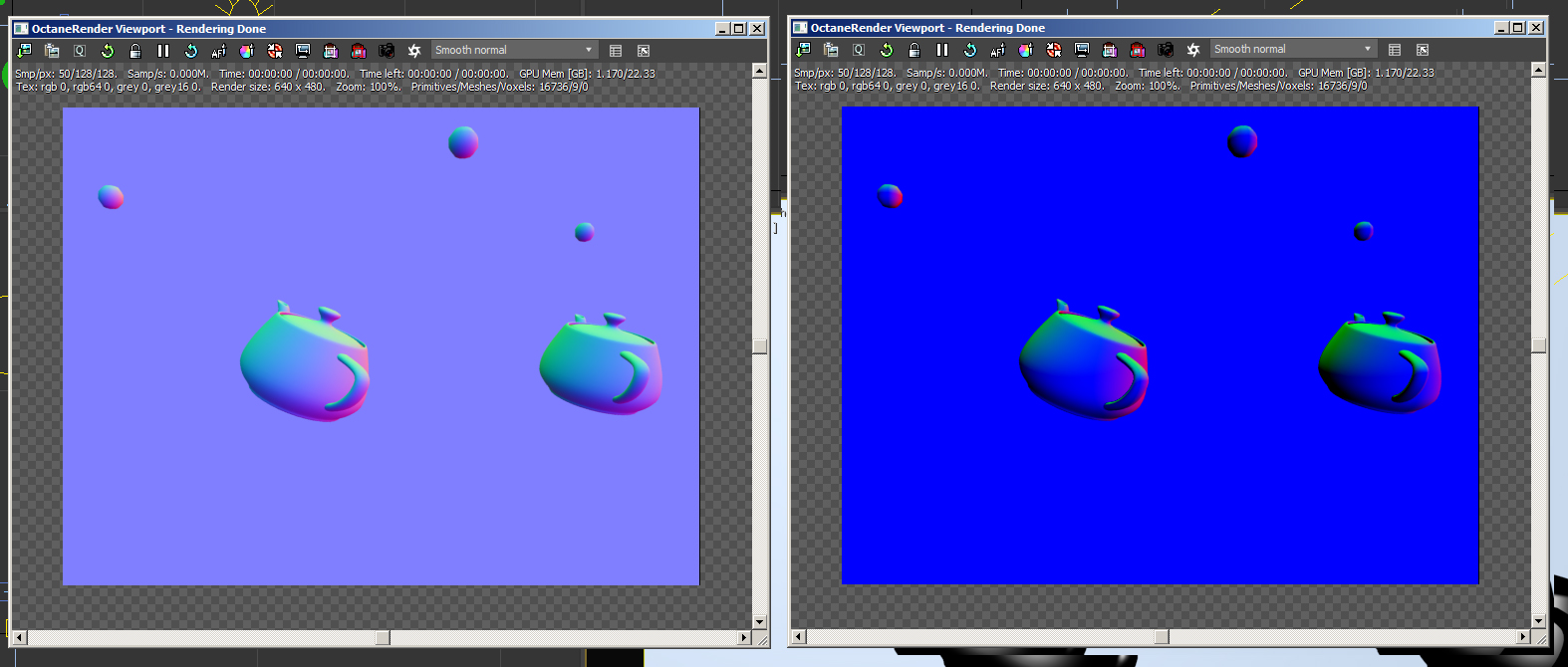

HI guys,

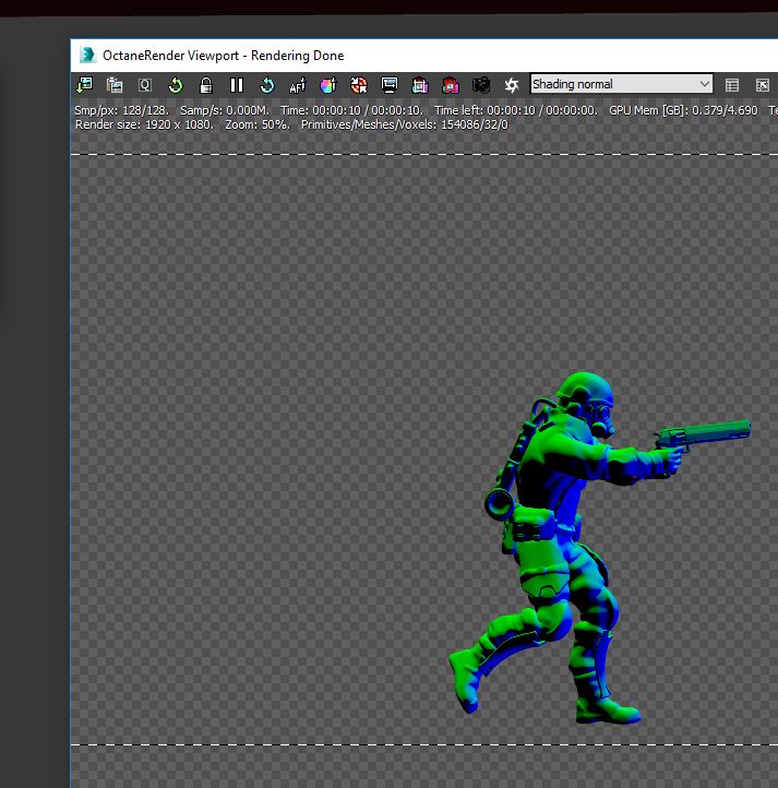

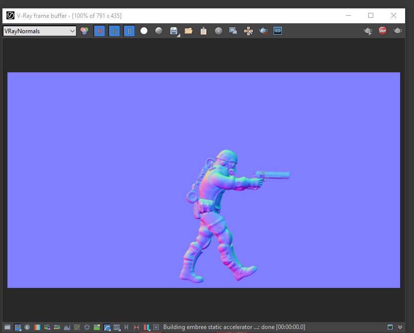

Is there a way to render out normal pass like vray normal colour ? octane render looks very weird to other software normal passes
please see screen shot
vraynormal pass / and all other software render normal pass look this one

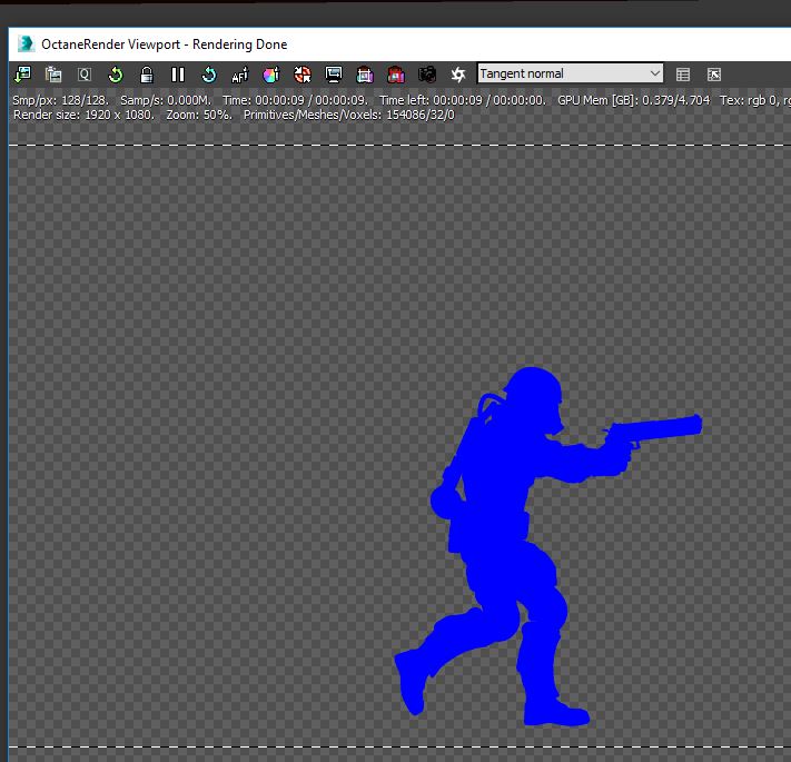

Octane normal passes

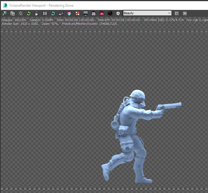

and beati pass here
I am using latest octane 4
J

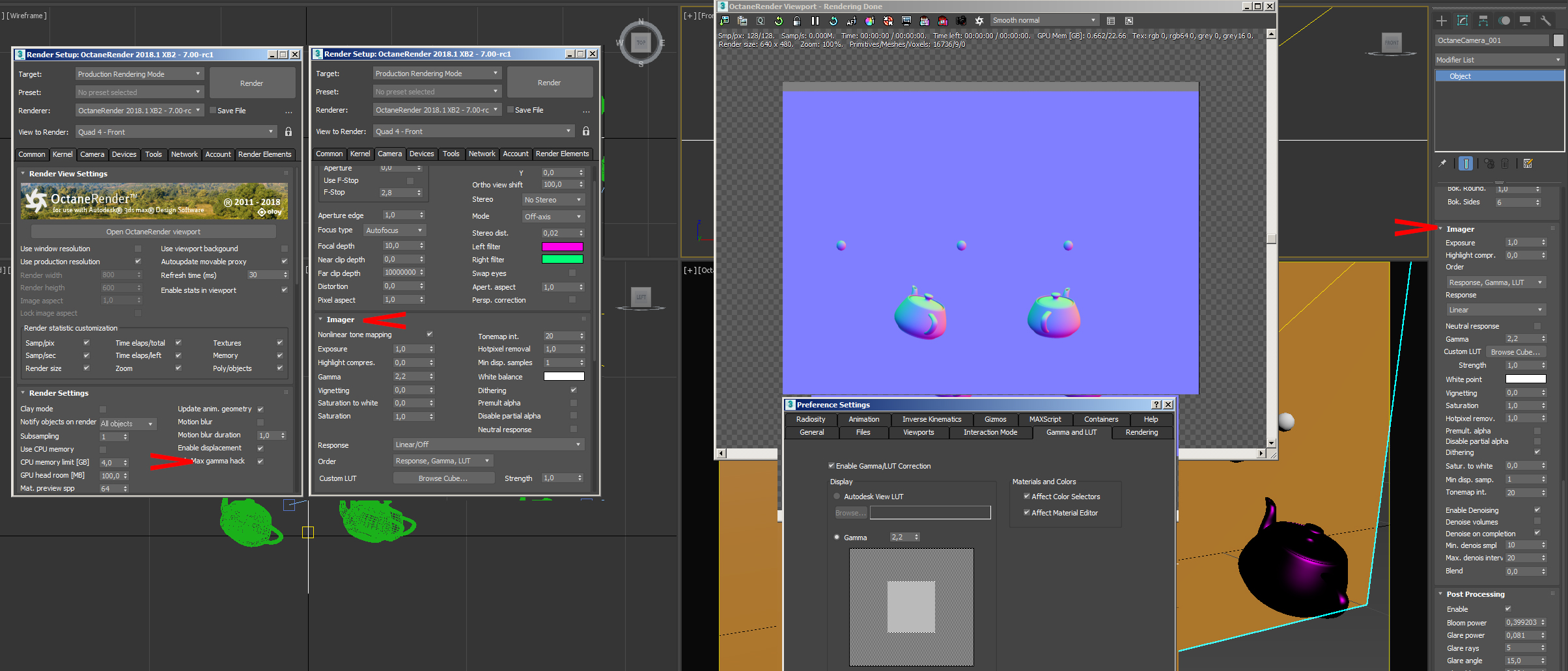

Hi Jim99,
I think your issue depends on your Gamma setting.
Regards
Paride

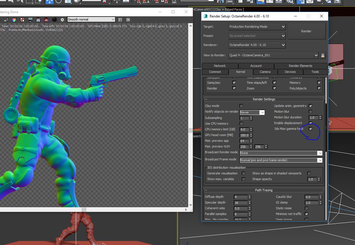

jim99
Posts: 74
Joined: Wed Aug 19, 2015 6:07 am
HI Paride,
Thanks for your quick reply, I have double check on my max gamma setting its set to 2.2 gamma but the render still doesnt come out
like yours do, could you screen your setting please ? I have tried tone map in octane its doesn't right either
J
paride4331
Posts: 3997
Hi jim99,
here for you.
Regards
Paride

jim99
Posts: 74
Hi Paride,
It seems my octane still have issue rendering out normal pass like yours, I have check all settings. Please help
could it be my version of octane 6.10?
