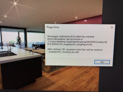

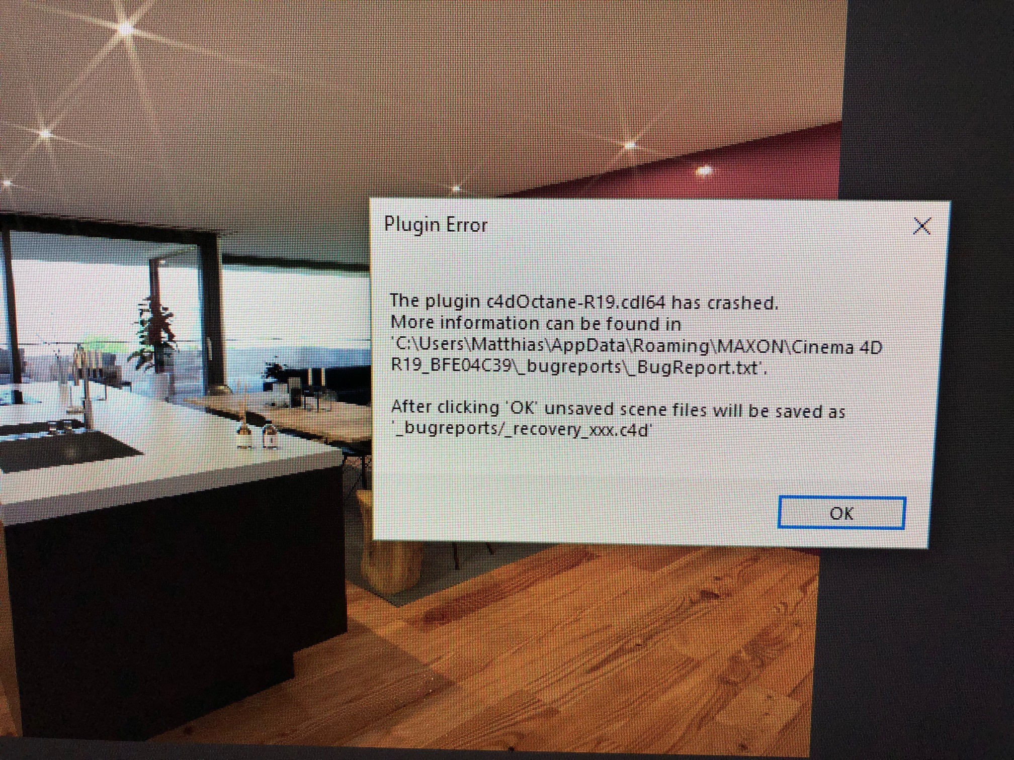

I urgently need help, cinema4d works anyway octane render synonymous. When I render the image in the image manager, everything works to the point where I cancel the rendering or the rendering is done. When I stop rendering, the cinema 4d crashes.
when the picture is ready rendered and I think so, now finally I can save ... in the last few seconds before closing it crashes.
I do not know how to continue, everything works fine in the live viewer.

plugin c4dOctane-r19.cdl64 crashes while saving or stop rend

this problem exists in this file with an interior rendering, pathtrace, hdri, blackbody, 12gb out of core, denoise etc.
without render passes.
used plugins is only octane, the other plugins I did not use. and is the same as standalone.
