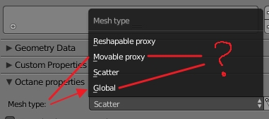

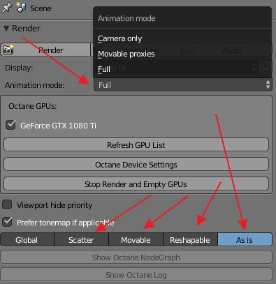

I also have a few questions about how to use and what it is.
Marked with red arrows.

Switch to Camera only animation mode. This should speed things up. If possible flatten modifiers too.
Here is the description of the object types:
https://docs.otoy.com/BlenderH/BlenderP ... yTypes.htm

If you set animation mode to "Movable proxies" it will allow to render transformed and distorted objects. Camera animation is also taken into account.
"Camera only" renders static objects with only animated camera. Probably the fastest mode.
"Full" mode does probably both. I could not any info on this.
