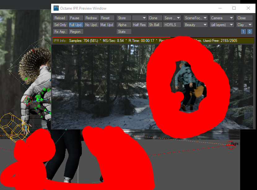

I'm having the weirdest FiberFX issue at the moment.
Octane seems to 'offset' the position of the Fibers when rendering.
I did find this thread....
viewtopic.php?f=36&t=51482&p=256281&hil ... fx#p256281
That shows a solution, but it doesn't seem to work for me.
The 'hair' is made using 2 point poly chains, with Bullet dynamics applied. I thought it might be something to do with Bullet so I mdd'd the hair, but the problem still persists.
Very confusing as I've used FiberFX with Octane before but can't remember if I had the same issue or not.
Using LW2015.3 and Octane 3.08.2.0
((Image Attached, parts redacted due to NDA))

Well,
Never mind, It appears to have fixed itself. lol.
So very strange.

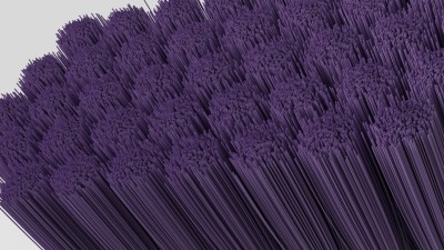

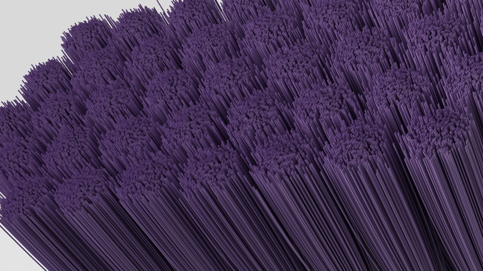

I have a question about FFX - is octane supported End Caps function?
I'm trying to create a toothbrush bristle, but instead of bristles I get hollow tubes. Choosing the type of caps does not affect anything.

promity wrote:I have a question about FFX - is octane supported End Caps function?
Nope, sorry. Currently, the Octane curves don't support the end caps feature. Perhaps as a workaround, you could try to instance a sphere in the curves final points.
