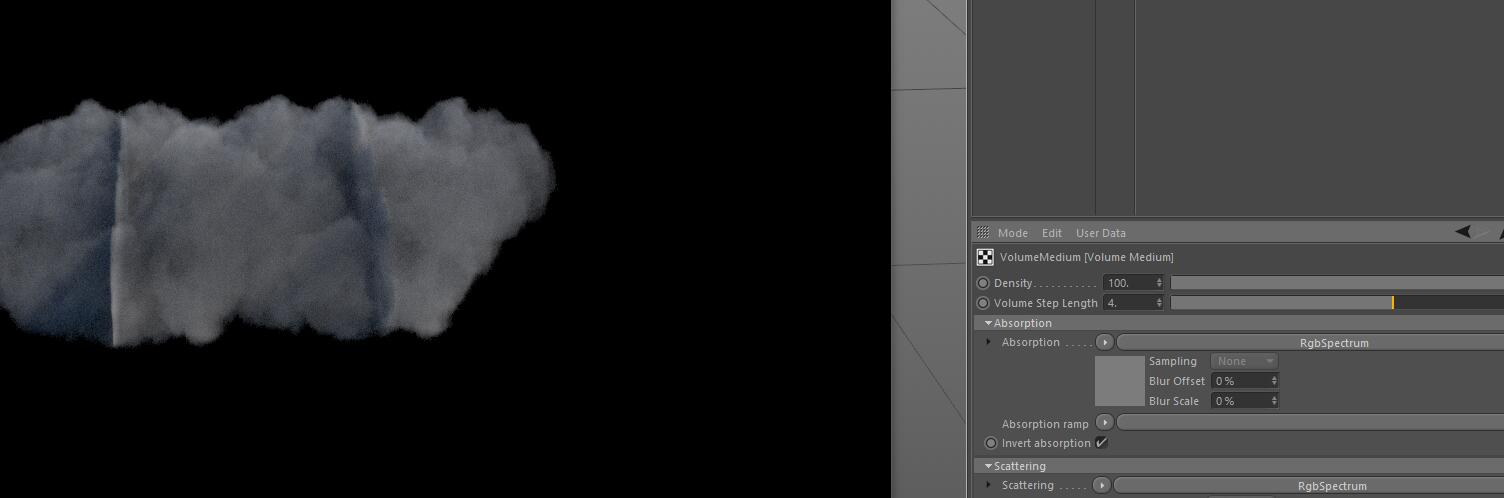

strange vdb overlapping boundary
clarkx
Posts: 15
Joined: Sun Nov 20, 2016 11:55 am
using 4.01
is there any solution?
if 2 vdb get close,strange boundary appear..

in medium,the Volume step length both 4(default),but it still seams there、...?

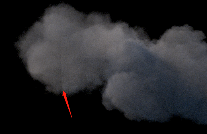

any news about this behavior?
looks like it still happen in 2020.1.5-R3

I am also seeing this in renders within 2020.1.5 of overlapping VDB.
Is there any update on a fix for this?

Still happening in 2020.2.3. C'mon, guys. :x

Still happening in 2021.1-(R4).

Hello,
today I've come across this problem and spent some time to solve it, but I couldn't.
Is there any explanation about this issue?
