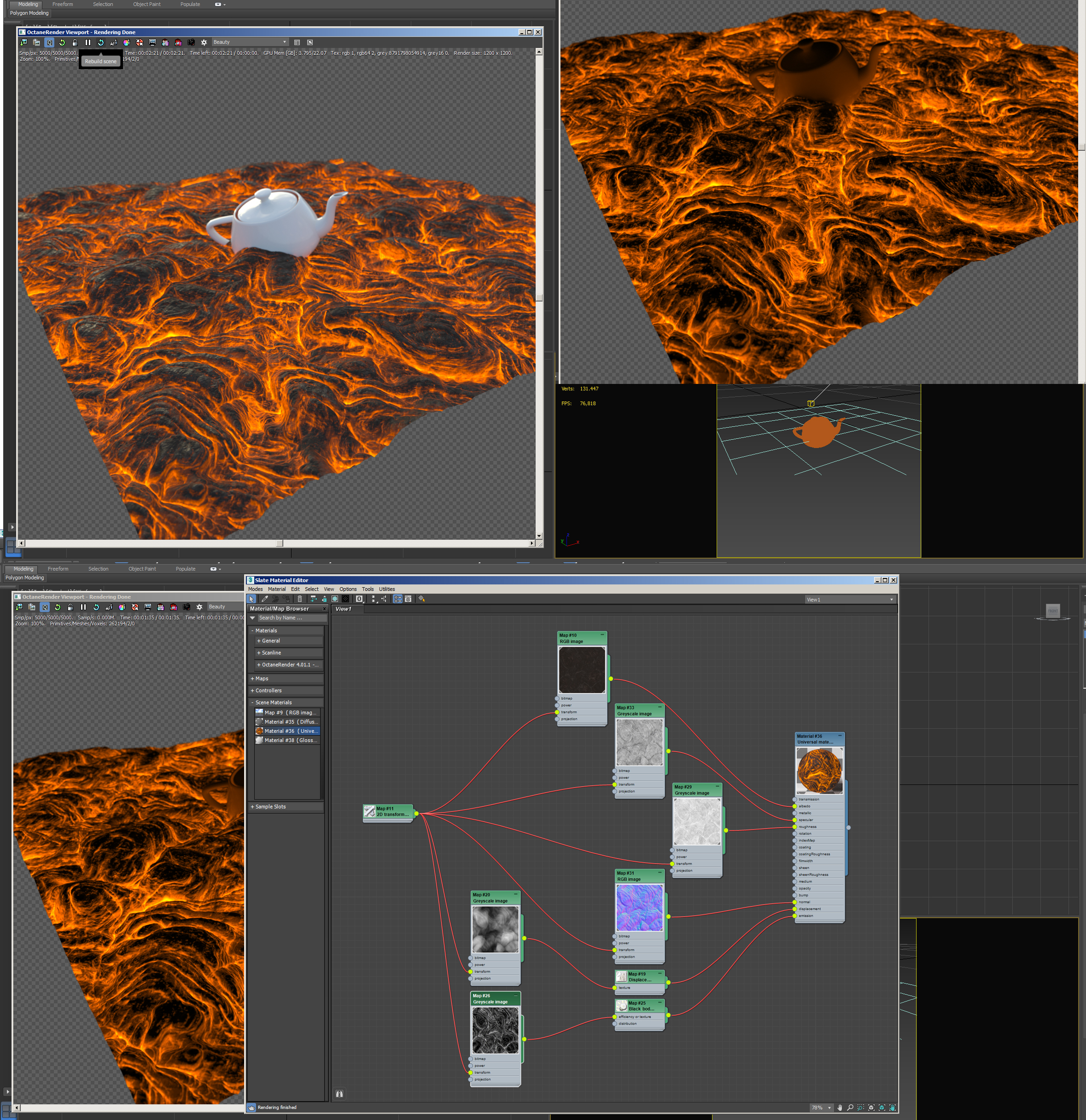

In this example, there are emission and specular but It's not a mix material.
