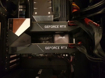

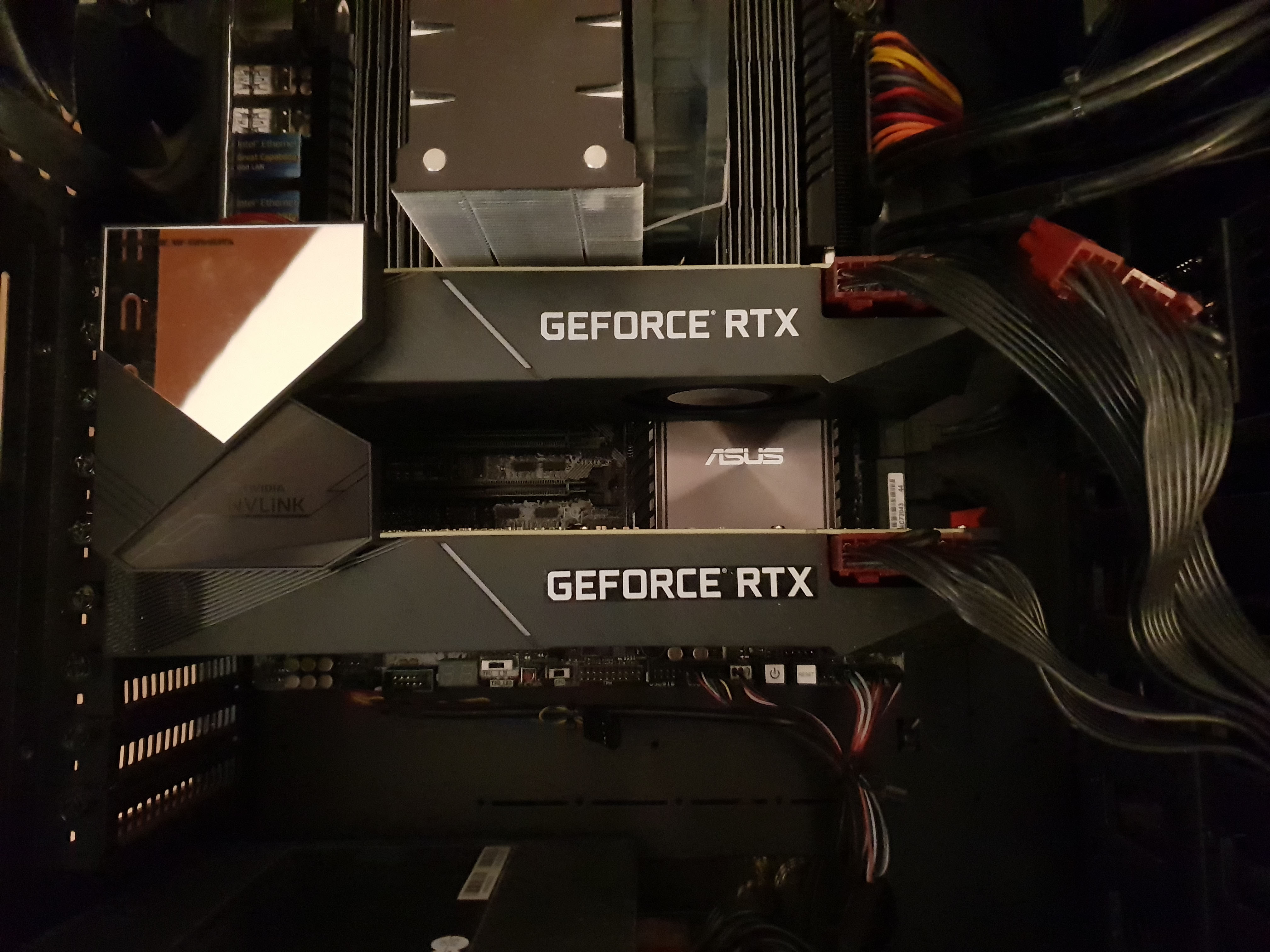

- installed Asus NVLink Bridge 4-Slot
Asus NV Link Bridge 4-Slot
2x RTX 2080 Ti - NV Link 4 Slot

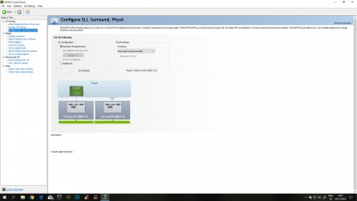

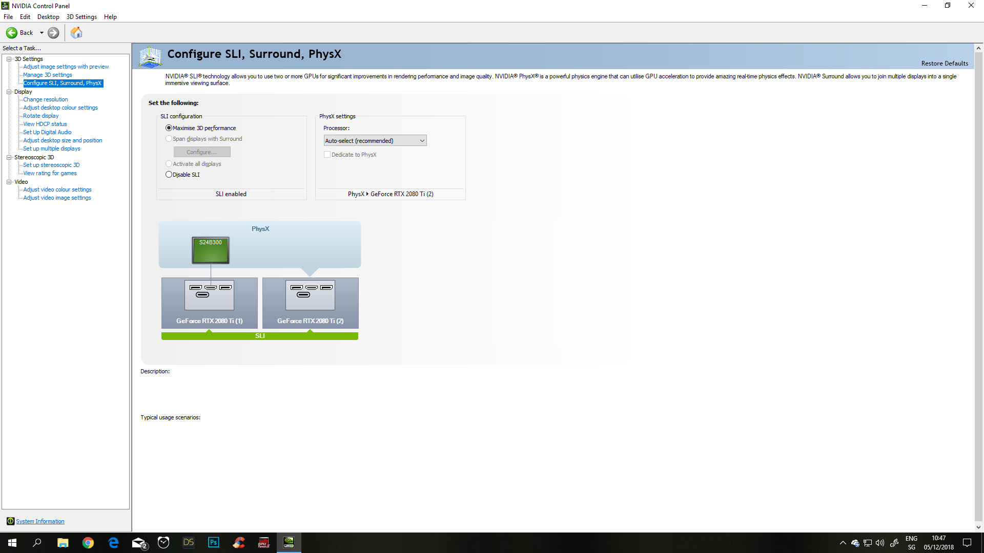

- checked SLI status in Nvidia Control Panel: SLI enabled
RTX 2080 Ti - Sli enabled

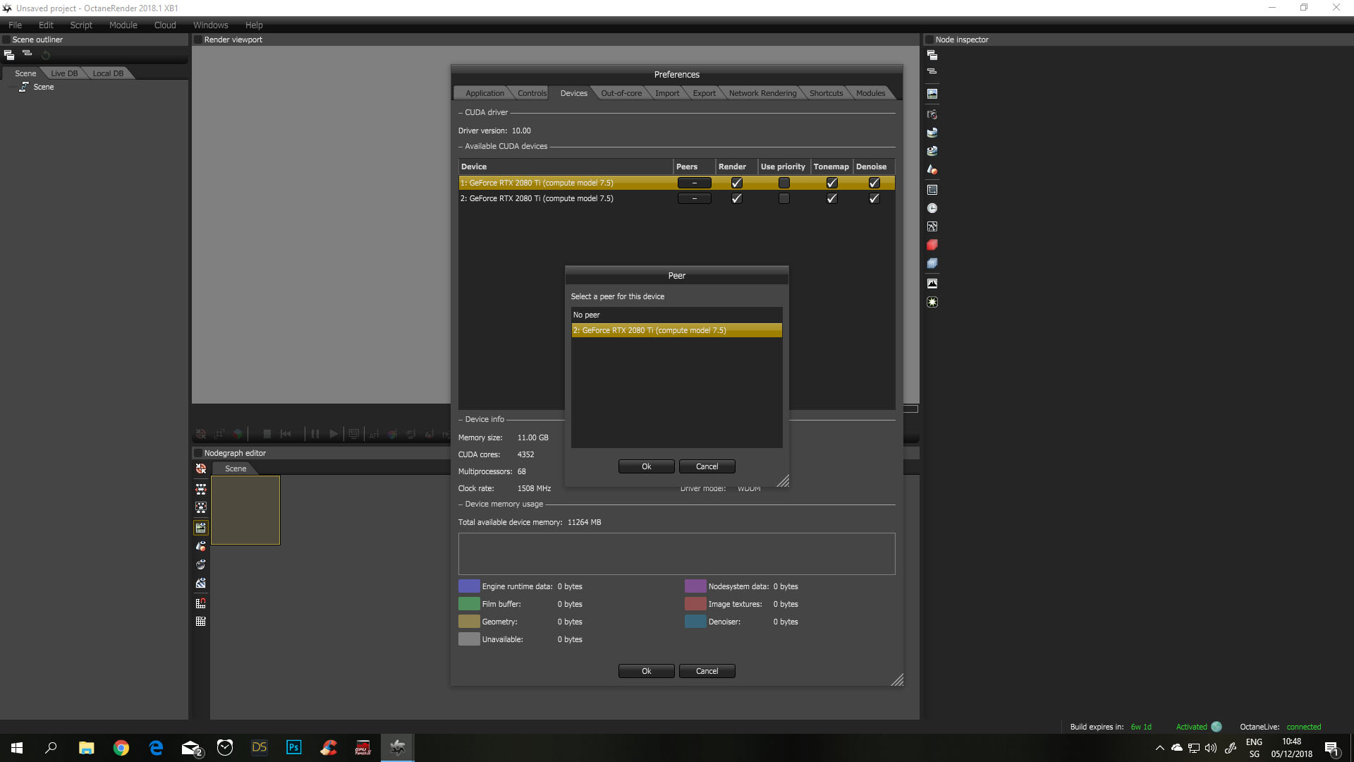

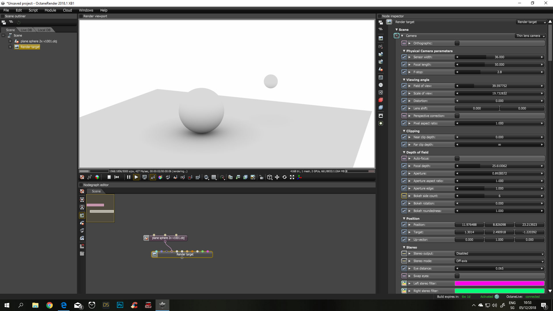

- Octane Render 2018.1 XB1 - Preferences - Devices
tried to assign a Peer
Preferences - Devices - Peer
Unfortunately still at VRAM 11264 MB
VRAM 11264 MB
VRAM 11264 MB
I expected available VRAM to change to ~ 22'000 MB.
Based on the image shared in the Development build releases thread there seems to be a NVLink Quicktest but I do not know how to access that.

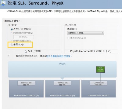

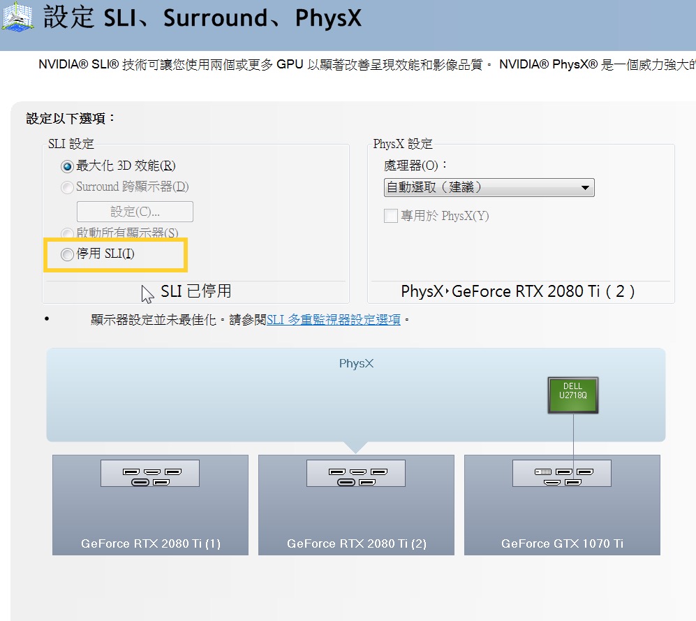

I have three cards on my system but I fail to see the option to enable SLI in Nvidia's Control Panel,
anyhelp would be appreciated.

oscartung wrote:I have three cards on my system but I fail to see the option to enable SLI in Nvidia's Control Panel,
When I tried use one GTX 1080 as display card and two RTX 2080 Ti linked together with a NV Link it was not possible to activate SLI in the Nvidia Control panel.
For using NV Link it seems required that the display is connected to one of the RTX cards that are attached to the NV Link Bridge.
oh that's a a pity, using the card simultaneous for the display and rendering would heavily affect viewport performance
roeland
Posts: 1824
it seems required that the display is connected …
I think that is correct. You also often have to use specific slots on your motherboard.
